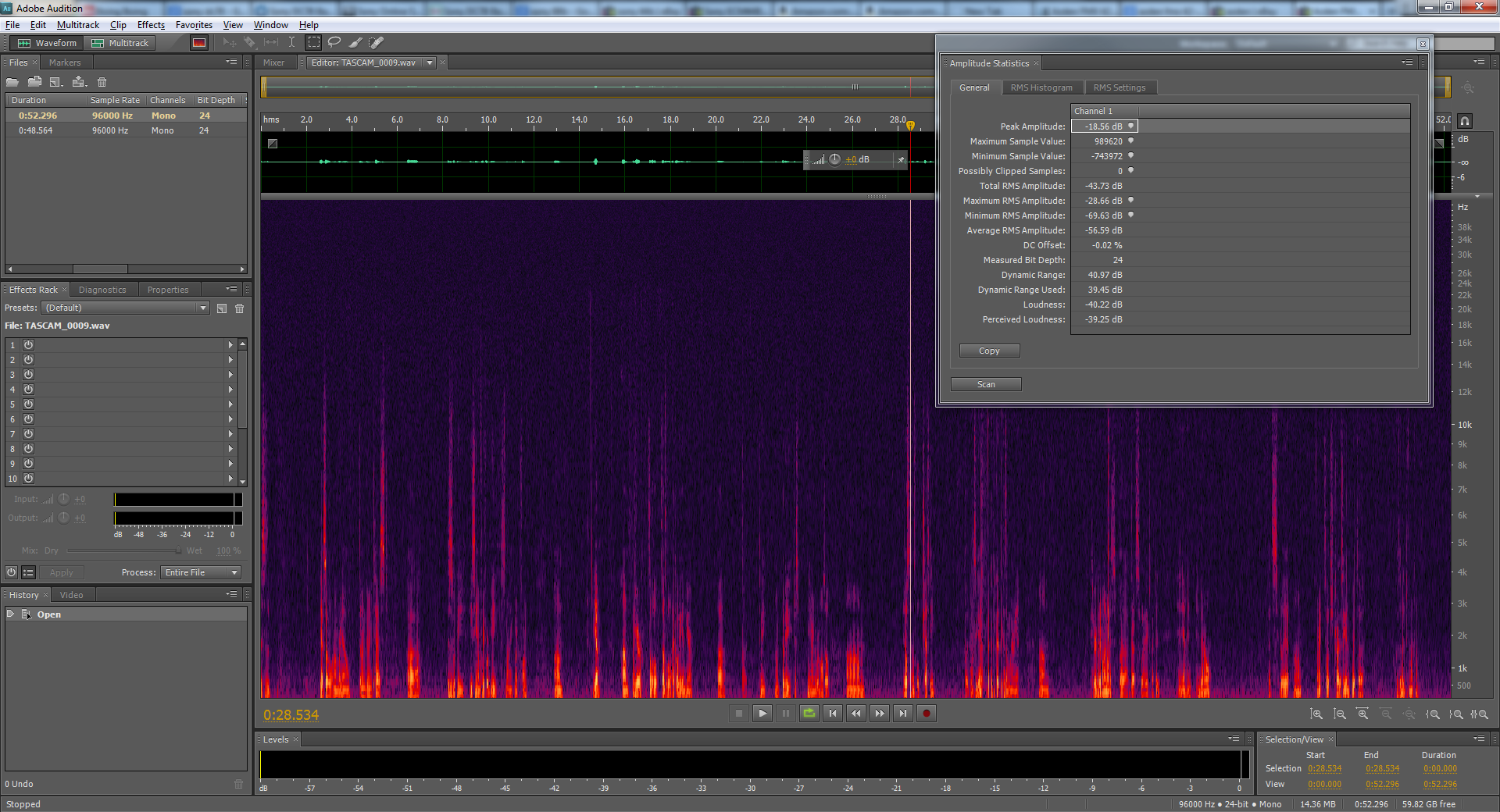

Ok, so I just borrowed a Sony 88B lav mic from a friend to do some comparison tests between it and the 44B.
I would say for the most part, they performed about the same, the 88B had a bit more dynamic range. Both had low output signal, and the same noise level. So it seems clear the issue is with the Tascam DR-40's preamps (I also tested it with a cheap-o hand held dynamic mic, mostly the same deal.)
The input level on the DR-40 was at 68 percent. I have attached a sample of the audio of the 44B, which peaked at -18.5 dB. I then normalized this to -2 dB in Adobe Audition, so you could hear the noise level at a practical amplitude. Also, I'm attaching a screen shot of the spectral graph and amplitude statistics from Audition prior to normalization.

That's a bit noisy, it's difficult to distinguish the electronic from the acoustical borne BG noise.

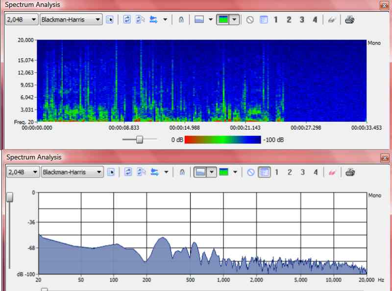

I've never used my DR40's own preamps so out of curiosity I plugged in an ECM55, with an near spent AA battery. The mic was plugged directly into the DR40's XLR-L, mono mode, Phantom Pwr. off, 44.1k/16bit .wav. The DR40 rec level was set to 75, whilst recording the meters were peaking around -8.0dBFS, then peak-normalized to -2.0dBFS in Sound Forge Pro. The noise floor sits around -48dBFS. Similar to your test, the electronic/acoustic noise floors blend together. Not great, but better than I anticipated.

Rick, I'd say you definitely got less noise in your recording (even though you had the gain on the DR40 set a tad higher). I was recording in my bedroom at night, and only my desktop computer would have been producing fan noise at the time.
After doing a bit more research (particularly the video blogs posted by JuicedLink - biased, I know), I've determined that neither the H4N nor the DR40 have powerful enough preamps for such low output condenser mics. This means I will need to get a mixer/preamp.
