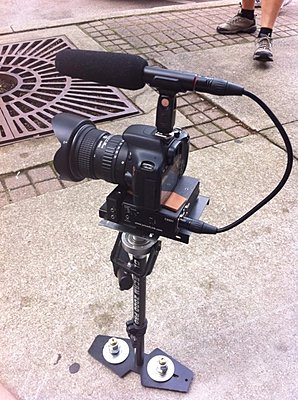

For the past 4 years I have been using a JuicedLink CX231 on the bottom of my T2i with an AT875R in the hot shoe mounted on top. I tried to attach a picture, Hopefully it worked.
What I am hoping to discuss is how well my audio set up fairs as it stands now vs newer approaches. Should I update? Should I do something different?
I am currently shooting a documentary where there are often large crowds and loud music. Interviews are a must so I am constantly trying to find a spot to hide away from the speakers to get good audio.
Any help would be greatly appreciated!

The question is .... what is your current audio sounding like? Do you like it, or not? Does it nearly do the job, but not quite? Let us know what you want to improve with the upgrade.
Old July 1st, 2013, 02:32 PM   #7
Location: New York
Posts: 2,044
Re: Advice on updating my audio equipment
A reporter's H/H may the easiest, normally a 635, RE50, VP64 or MD42, but you could use a 58 which would offer very good rejection.. of coarse it would need to be held close to the speaker's mouth and not moved much. An MD46 would be a better choice yet, it's a wide cardioid w/ great off-axis response.
Your set-up in the picture can probably work too, but you need to be very, very close to the interviewee, unless it's used H/H.. which it ain't designed for and may be prone to handling noise and moving it off-axis could be a problem as well.
