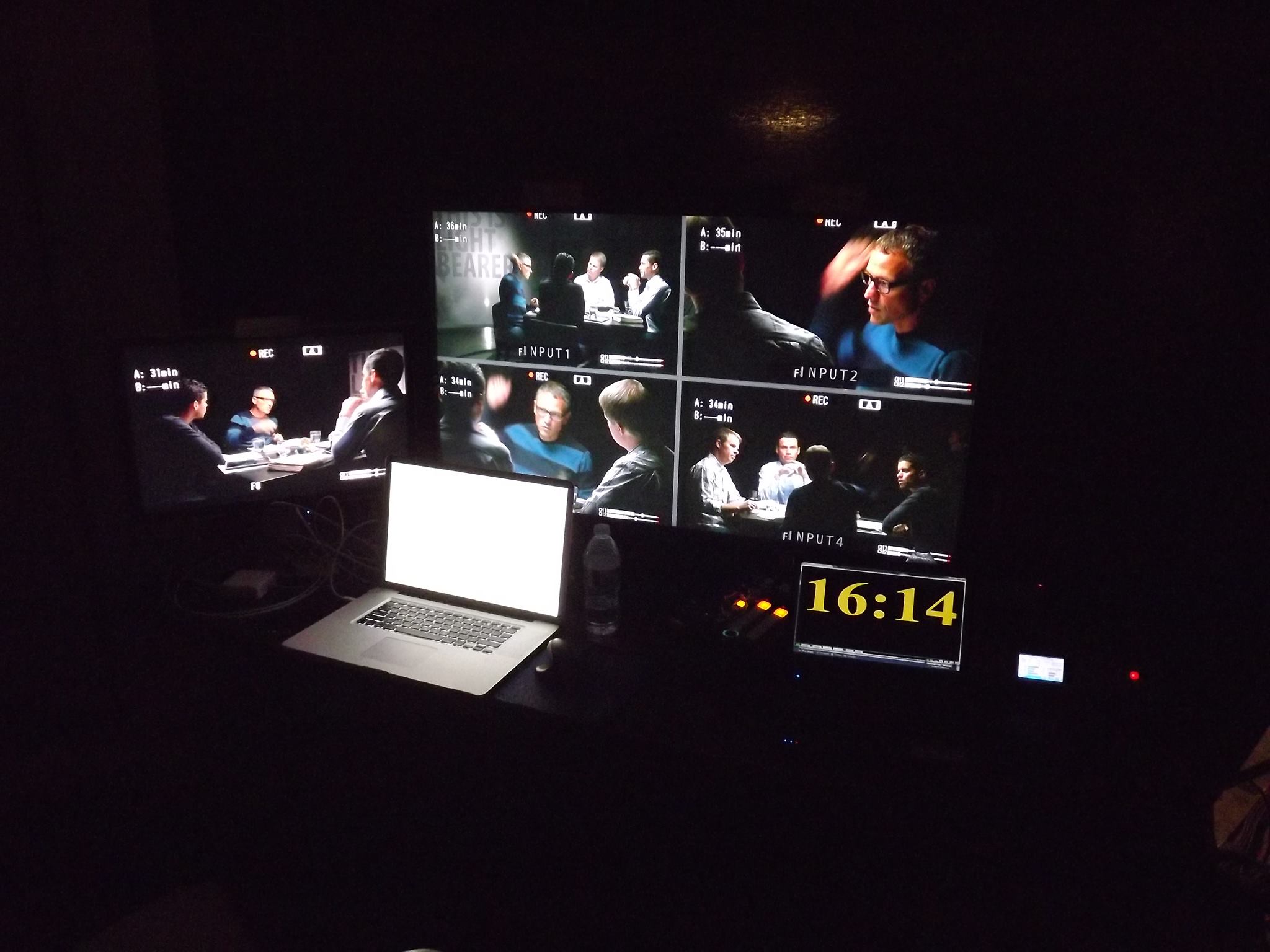

I used a quad mic splitter (EWI MST-412) and ran the direct feed from the mics to their corresponding Sony EX1 cameras. The cameras were providing the phantom power for the mics. Then I used the transformer iso splits to directly feed my (Oade Brothers upgraded) Edirol R-4 recorder. I set the record levels on the cameras on on the R4 during "rehearsal" (the 13 episodes were unscripted) and just "let 'er rip" during recording.
I took the SDI video feeds from the four fixed cameras and fed them into my Panasonic AW-HS50 video switcher which we only used as a quad-split multi-viewer. There was a fifth dolly camera on a circular track around the table. We used a Teredek wireless transmitter/receiver so the director could also see the moving dolly camera. (See photo)
I monitored the camera audio levels by viewing their "VU meter" indicators from their viewfinders. And I monitored the audio signal quality from the audio I was recording on the Edirol.

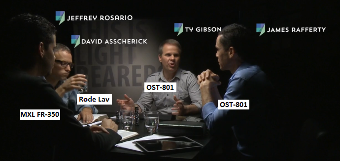

So which mic was which? I don't like the sound of them equally. I prefer a richer, fuller sound. I know this can differ by voice quality and EQ in post, but based on what is presented here, I like the sound of the guy in the black best, and the gray the least. The blue plaid is pretty good, but a bit thin for my taste, and the blue shirt is between the gray and the plaid. I've not been as impressed as some folks by the online tests of the Rode Lav, but if the black shirt is the Rode, I'll have to look into it further.
I do own (and really like) the OST, but since I like a sound that is less bright, and almost never have the lav under clothing, I got the 802 which has a bit less top end.

OK here is the revelation...
Ty Gibson (gray shirt) and James Rafferty (blue shirt) had the Oscar OST-801 mics.
David Asscherick (plaid shirt) had the Rode Lav, and
Jeffrey Rosario (charcoal sweater) had the MXL mic.

Very interesting! Based on this, I agree with your assessments.
1. The Rode has a unique sound which has some good aspects, but it's not to my taste and not worth the expense for me.
2. I made the right choice in choosing the OST-802, as the 801s are brighter than the sound I'm after.
3. The surprising performance of the MXL just shows how a good recorder with upgraded preamps in the hands of obviously a good operator can overcome inexpensive equipment. I'm not in the market for anything wired at the moment, but if I were and could live with the larger size, these would be a worthy option to pursue. I have an older Sony ECM 55, and the MXL sounds similar in many ways.
