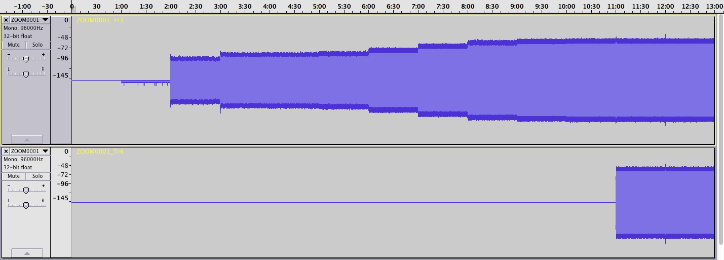

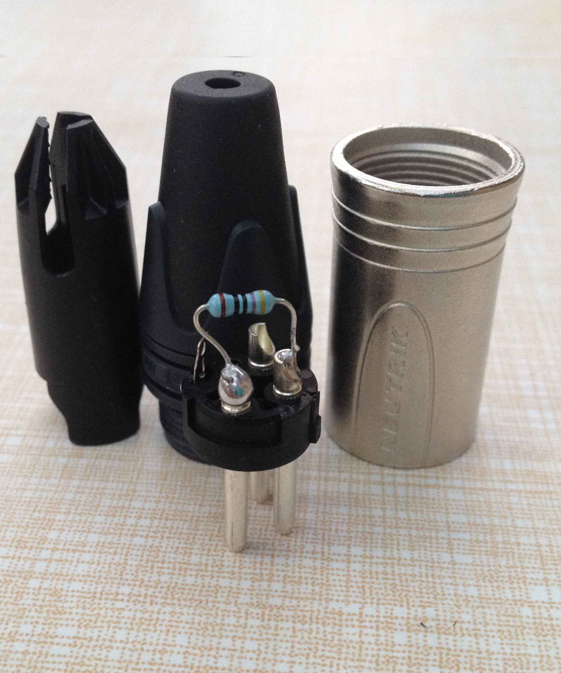

I nipped out and got myself a pack of good quality 470 ohm resistors and wired up two male Neutrik XLRs with a resistor across pins 2 & 3 as suggested, and repeated the tests. For convenience, I'll repeat the explanation of how it was done:
I recorded two empty WAV files at 96kHz/24bit on channels 3 and 4 of a Zoom H6. (This time the 470 ohm test resistors were connected to the channel 3 & 4 XLR input sockets, so what was recorded was still basically silence and circuit noise).
On Channel 3, I recorded as follows
from 00min 00sec with the H6 gain fully down at 0
from 01min 00sec with the gain at 1
from 02min 00sec with the gain at 2
from 03min 00sec with the gain at 3
and so on up to
from 10min 00sec until the end at 13min 00 with the gain at 10
On Channel 4, I recorded as follows
from 00min 00sec with the H6 gain fully down at 0,
from 11min 00sec with the gain fully up at 10 (as Ch 3)
from 12min 00 sec I switched on the -20dB pad on the Ch 4 input
After importing the two new files into Audacity, the result now looks a little different.
Ignoring the first minute with the gain at zero and also the second minute where there is again a strange offset of the noise pattern, I see the following:
•the noise at gain level 2 comes in at almost exactly -96dB
•there is a slight increase at gain level 3 to about -84dB
•the noise level stays much the same through gain levels 4 and 5
•another slight increase at gain level 6 to about -72dB
•slight increase again at level 7 to about -64dB
•at level 8 up to about -58dB
•up at gain level 9 to about -52ish dB
•stays much the same at gain level 10, and this is matched by Ch4 underneath.
The -20 dB pad on Ch4 at 12min 00sec puts a click on BOTH channels which is not so good, but otherwise does not seem to affect the noise level much.
I will continue to amuse myself by testing the other inputs (well 1 & 2 at least, as the plug-in XLR module for the L & R channels is not available yet).
Usual disclaimers apply to all the above, but it may be of interest to some.
Anyone used a Zoom H6 yet?-zoomh6_470ohms_test.jpg   Anyone used a Zoom H6 yet?-test_470_ohm_xlr.jpg

It's incorrect that you're recording "silence." Even the best low noise resistors generate noise, it's called thermal noise. Johnson?Nyquist noise - Wikipedia, the free encyclopedia
I believe you'll find that any device that adds gain increases the volume of this noise. It's hard to imagine things working otherwise.

Yes thanks, I am aware of the thermal noise issue when using resistors and did make a ( very!) fleeting reference to it my post #12. My maths is rather rusty so I was hoping some kind soul would make a simple suggestion to improve the first 'test' - thanks again Greg for the value of the resistor!
As I said in my disclaimers, I make no claims for the significance of my quick 'tests', but there must be some method of determining accurately the level of self noise in mic preamps under known conditions and I was curious to know whether anyone (other than Zoom themselves, one would hope) had done it.
