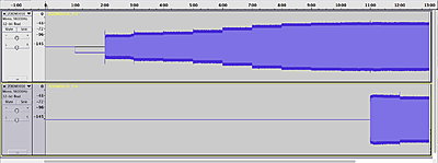

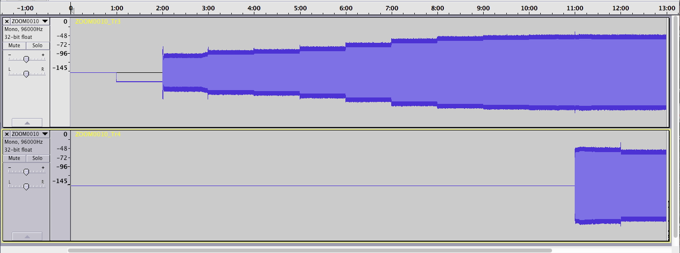

Not quite sure what, if anything, this proves, but here it is anyway:
I recorded two empty WAV files at 96kHz/24bit on channels 3 and 4 of a Zoom H6. No mic or line inputs were connected to the XLR/TRS input sockets, so what was recorded was basically silence with circuit noise and possibly a modicum of digital dross.
On Channel 3, I recorded as follows
from 00min 00sec with the H6 gain fully down at 0
from 01min 00sec with the gain at 1
from 02min 00sec with the gain at 2
from 03min 00sec with the gain at 3
and so on up to
from 10min 00sec until the end at 13min 00 with the gain at 10
On Channel 4, I recorded as follows
from 00min 00sec with the H6 gain fully down at 0,
from 11min 00sec with the gain fully up at 10 (as Ch 3)
from 12min 00 sec I switched on the -20dB pad on the Ch 4 input
After importing the two files into Audacity, the result looked as in the pic below.
Conclusions I can draw from this
(1) The H6 preamps are pretty quiet with the gains fully down :-)
(2) It gets noisier as the gain is increased :-)
(3) Both channels seem to behave in a similar fashion
(4) A clean hot signal would stand a better chance of being recorded acceptably (this did not necessarily work with the H4n)
As for the strange negative offset from 01:00 to 02:00 on Ch3, I have no explanation. Might be a problem with Audacity rather than the H6.

I've been pondering an H6 so this is interesting... thanks for performing the tests and posting the results!
From my experience, it might be more relevant to terminate each input with a resistance that is roughly equal to the source impedance of a mic. The value shouldn't be too critical. So, for example, I'd perform the test with perhaps a 470 ohm resistor connected between pins 2 and 3. This will tend to make the noise level more realistic, because open inputs can have relatively higher noise level than you'd experience with a source connected. And of course it won't cause any problems with phantom powering, as long as you connect only between pins 2 and 3, and leave pin 1 (ground) unconnected.
