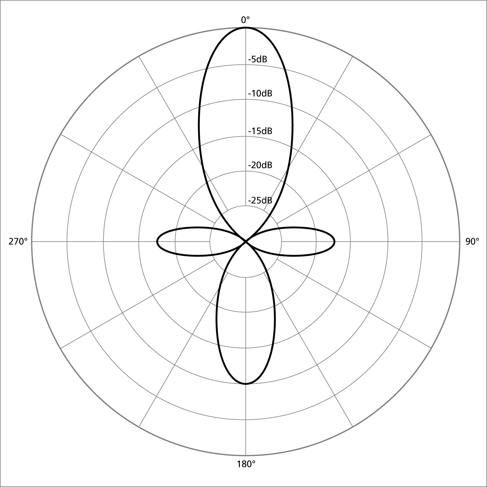

There is a specific issue with using shotguns indoors. They are not unidirectional at low frequencies, but have a rather large lobe of sensitivity to the back.
If you'll look at the diagram of a polar plot below, first, realize that it's an oversimplification. The polar pattern of a shotgun varies with frequency. This plot is for low frequencies. The problem noted below reduces as frequency rises.
Now, imagine that sensitivity out the back, with the back of the mic pointed to a reflective ceiling or wall, and now we get a whole bunch of out of phase LF going into the recording. This is classic comb filtering in the audio spectrum, and it sounds BAD!
On the other hand, in a different room, it's going to be different. Specific reflections, overall reverberation, distance from the mic, loudness of the subject, all play a part. Someone pointed out that the closer the mic is to the subject, the more direct the sound is - that's true too, and if you follow the guidance of the inverse-square law, a small change in position can have a larger effect than one might expect.
(diagram attribution: wikimedia commons)
