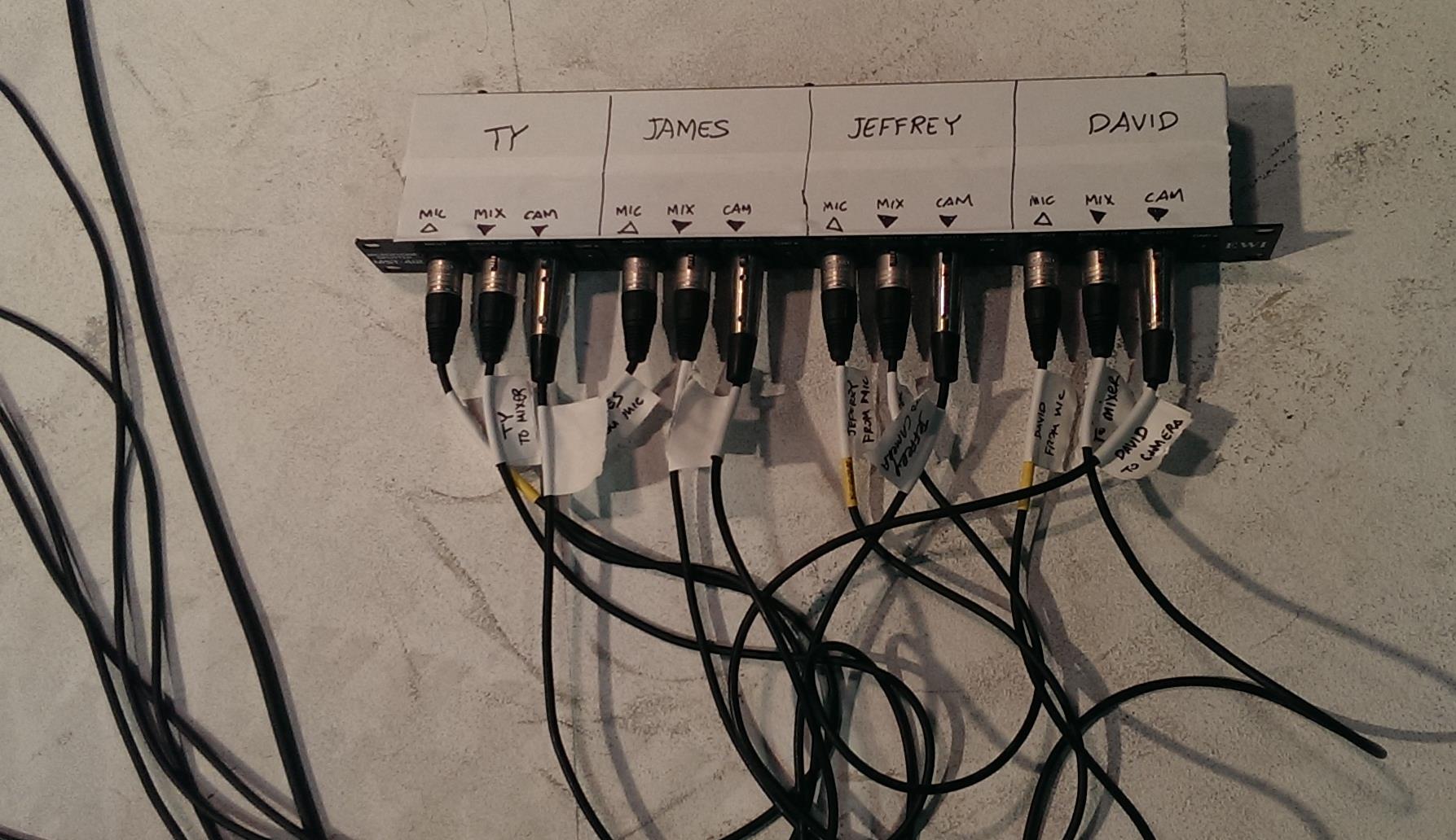

What's your kit-list to attach various sound desks to your cam's XLR input?-ttms.jpg
