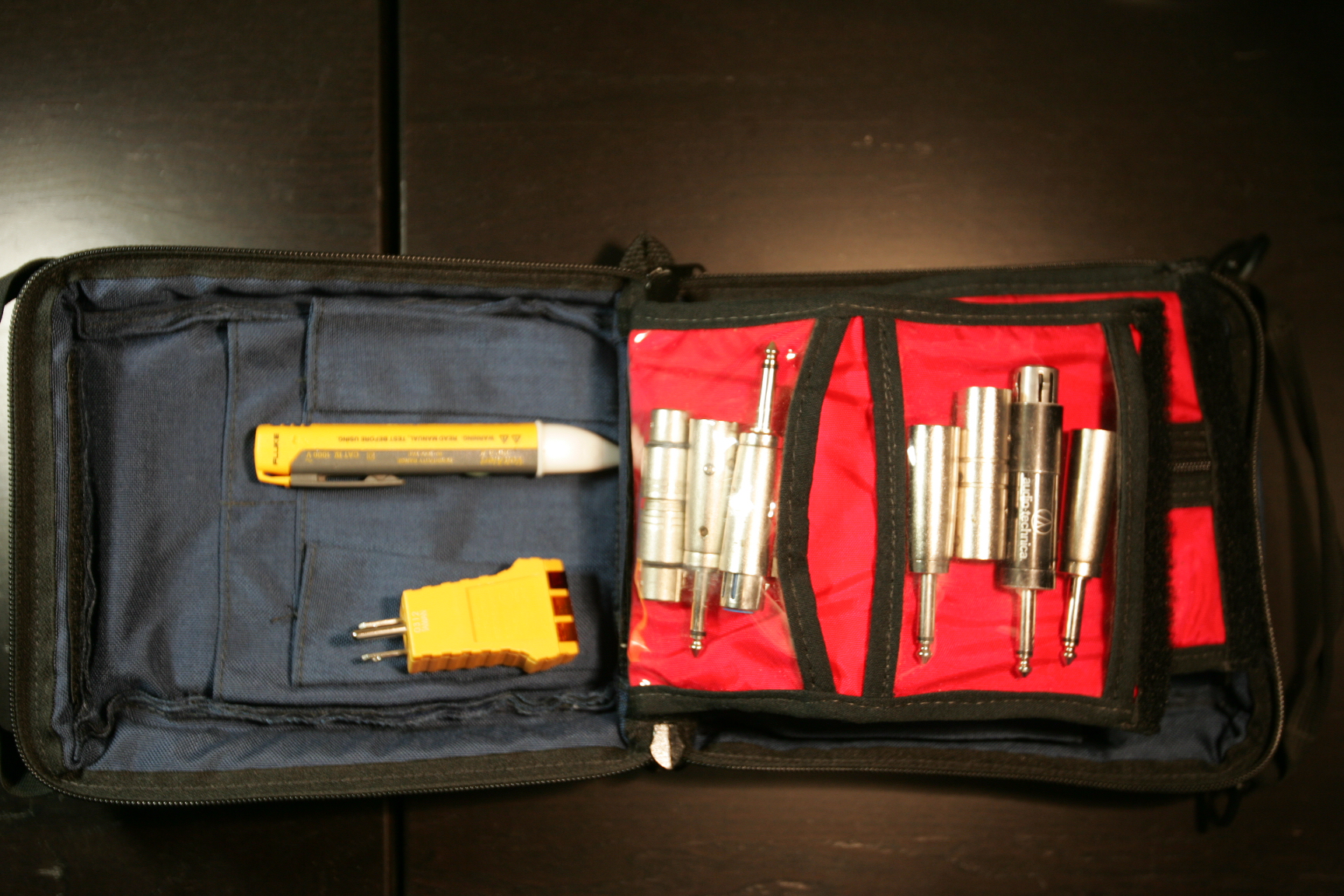

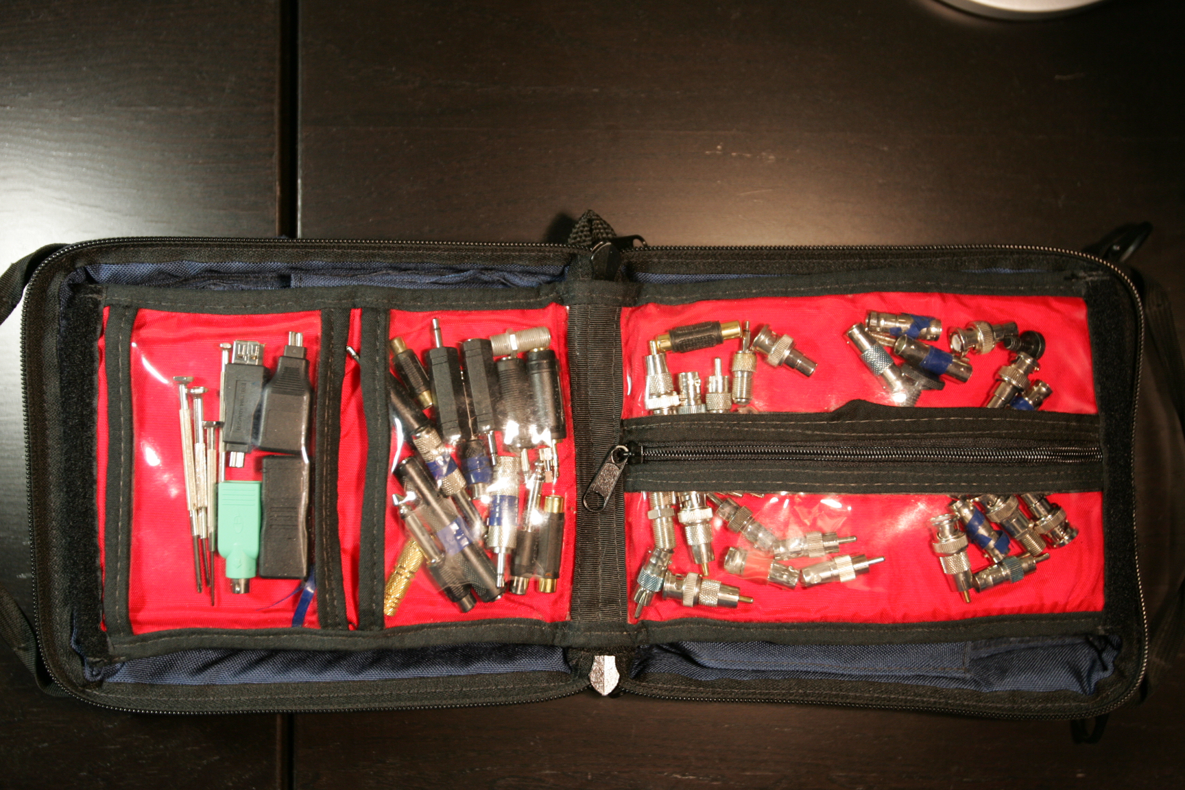

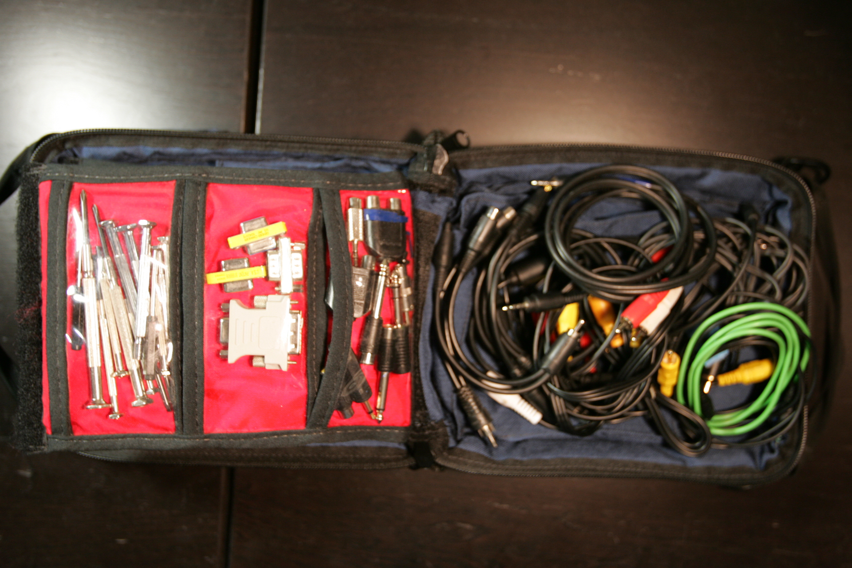

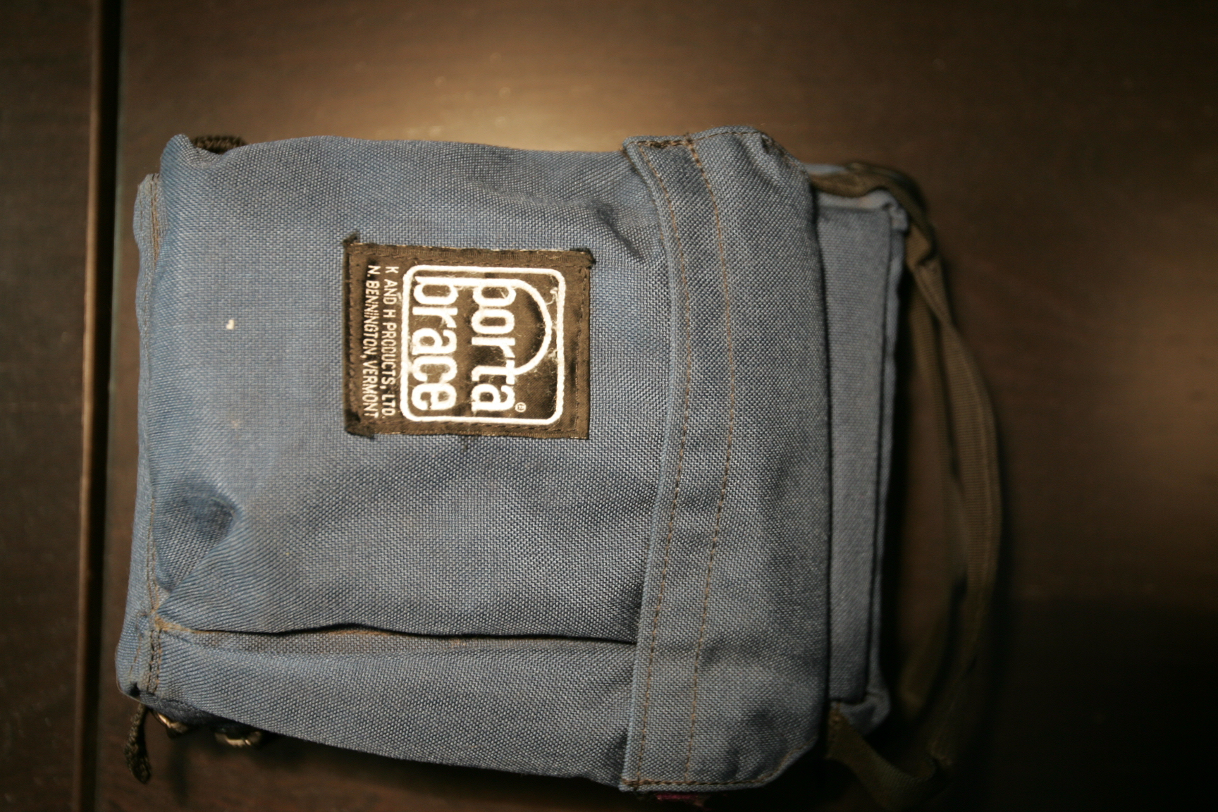

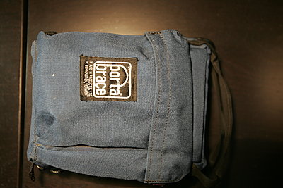

This kit is my first line of defense because it fits in my briefcase. That is important because it means it is ALWAYS with me. I have other kits that vary in size and complexity.
The pile of cables fit in a pocket in the case. There are also things you can't see, like my Leatherman tool, flashlight, zip ties, and board tape.
For me, these kits are not a one time thing. They change and evolve. Unfortunately there is also inventory control and attrition involved.
I do not think I have ever been on a gig when I did not reach for this bag at least once. It has literally saved shows when we needed something in a hurry and I had it within reach.
Steve
I keep a cheap Leatherman knock off from Home Depot in that case. I am out two real Leatherman tools. Both of them were stolen from tech tables. Weird, at least $100,000.00 in gear on those tables and my leatherman gets clipped. I guess it is hard to fit a 32 channel board into your pocket!

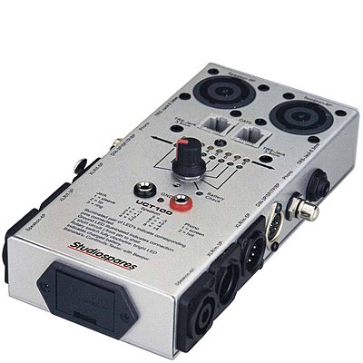

I hesitate to add to this very thorough exploration of essential kit, but I don't remember seeing any reference to any sort of cable tester (and do pardon me if I missed it). I won't go on any sort of gig which involves setting up audio stuff without my trusty cable tester.
Even with the best of gear correctly rigged used and stored there can be problems, and it's great to be able to eliminate cable faults if there's a issue. It's can save a great deal of time to be able to prove that the problem is not your cabling, and that it lies elsewhere.
I have lost count of the number of times I have been able to help out a panicking keyboard bass or guitar player (and even more than one sound tech!) by finding their duff connection for them. It amazes me why some of these guys never think to have one themselves. Don't start me on some folks' inability to diagnose faults logically and systematically :-)

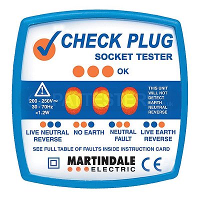

Oh, and I always test the mains power outlets too. Found a few horrors there I can tell you.
