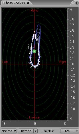

Tree Frogs: A slight stereo image.
Sound Forge indicates 'in phase'. The same rendered to mono, no audible abnormalities. Other than that I have no comments.

Very interesting, Rick. Thanks for providing some more food for thought. Were you sampling any particular place in the file?
I selected just one brief section of the file where the frogs were much more audible than the motor, somewhere around 22.5 seconds into the file. Other places, where the motor sound predominates, the picture is much different, with the motor sound quite visible and changing in phase and channel balance as the plane moves past. With the exception of the short times when the motor is much louder, the vectorscope always seems to be tilted into the second quadrant, i.e. more out-of-phase than in-phase material.

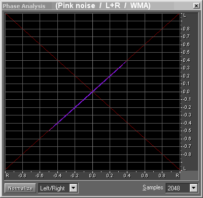

To verify that the vectorscope isn't fooling me, I recorded identical pink noise onto both tracks of a stereo file. (Not stereo pink noise. I recorded mono noise onto one track, then duplicated that onto the other track.) I then converted this to a .wma file, closed it, re-opened it, and viewed the vector display. A thin solid line in the middle of the first quadrant, as expected.

EDIT: I just looked at the "frogs and birds" file and that one is very strongly in phase! I wonder what accounts for the difference between the two files. It might be interesting to pursue the vector display of this file, if anyone else has any additional thoughts.

"Were you sampling any particular place in the file?"
Yes, but it's pretty consistent all the way through with no phase issues at all.
Same with these scopes:
