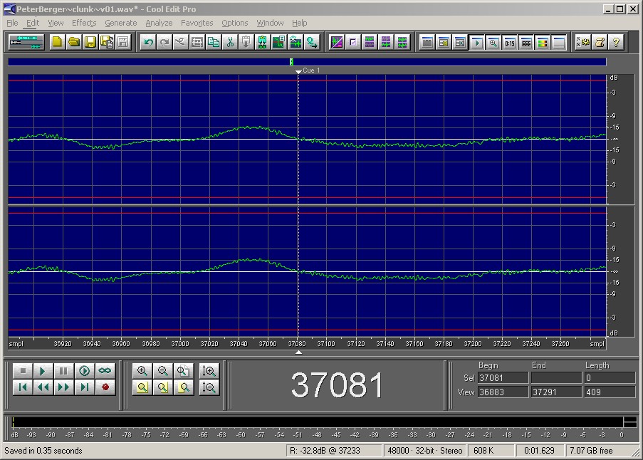

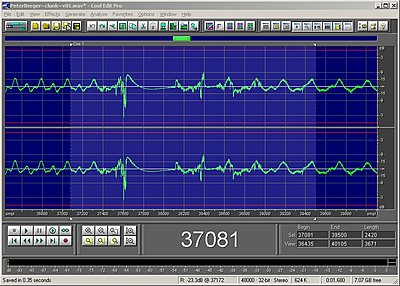

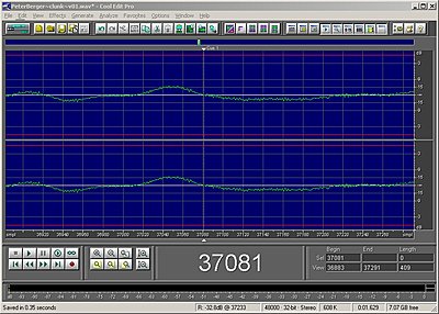

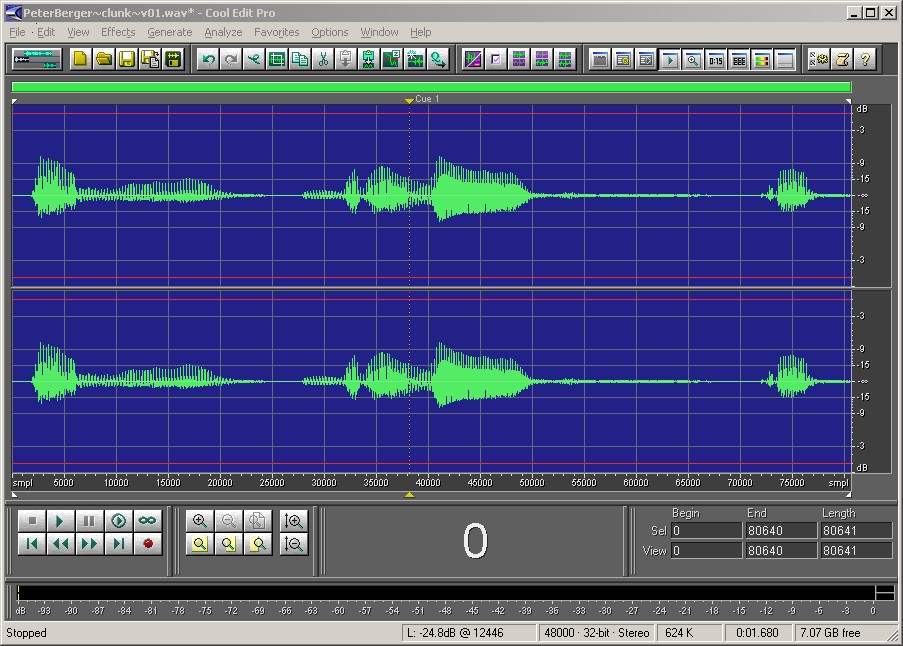

The simplest thing I could do was to remove the samples with the worst noise. In this case that was 2420 samples (roughly 50 msec.), beginning with sample number 37081 (see step1). I just cut on a negative-going zero crossing so there will be no abrupt transition at the cut point.
That will shorten the entire clip a bit (in this case from 80641 samples to 78220 samples (see step2). And then, if you need to maintain sync, you can either add a tiny bit of silence somewhere nearby, or else do a slight stretch (see step3) to get the length of the file back to the original number of samples.
Of course that's quick and dirty. It has taken much longer to type this and grab the screen shots than it took to fix the audio.
And sometimes it helps to "double up" the good samples just ahead of, and just after the cut, rather than fixing the sync issue by stretching. In the present case, I think it goes by pretty fast and doesn't sound too bad. attached file v01.wav below

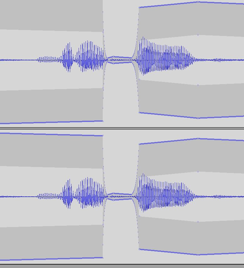

Another approach -- which is perhaps similar to the one you used, Peter, --- is to use an envelope tool (this one is is Audacity, excellent freeware) to lower the amplitude of the offending sound to a very small (but not-silent) level. One advantage is that the synchronization of the audio is not affected, and it sounds, if anything, like the speaker took a breath there....
