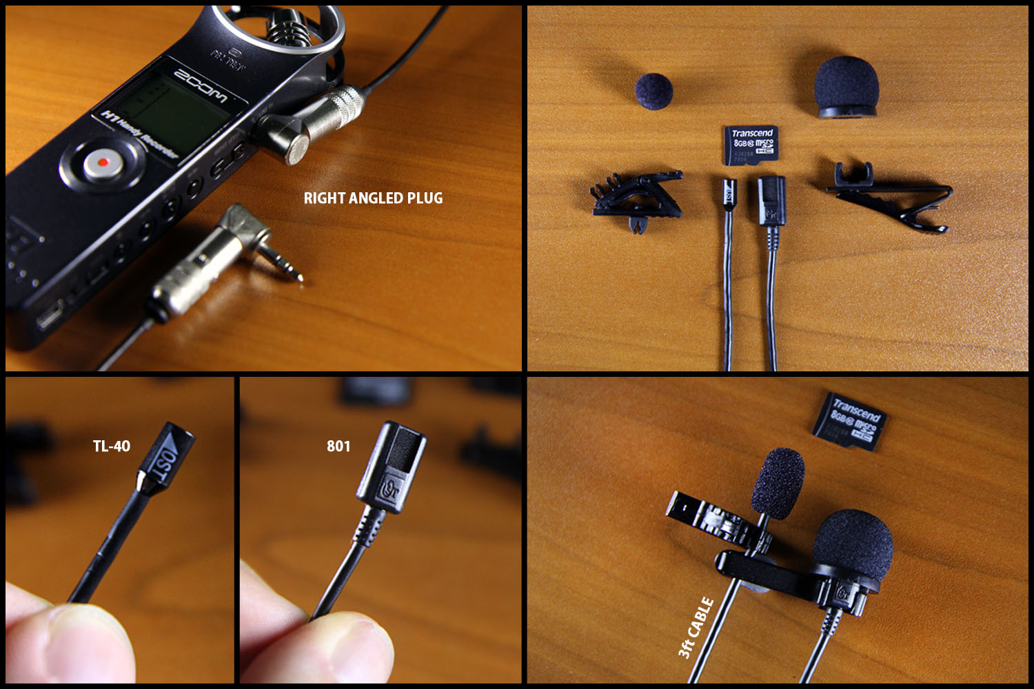

I ended up buying the OST TL-40 & 801. I couldn't really find anything about MM on the web so went with what is recommended, OST. I'm impressed with the construction quality of the OST mic's. The 801 has a high frequency boost which sounds bright compared to the TL-40. The 801 comes across as crisp with a bit of a sizzle. The TL-40 sounds very similar if not identical to the Sennheiser ME-2 to my subjective ears & very limited quick test. At first I preferred the sound of the 801 however the TL-40 has a more wholesome duller (natural) sound which I now prefer. I chose the right angled 3.5mm plug for my Zoom H1 which should minimize wear & tear on the cables over time keeping the recorder as a compact package. I usually place the recorder into the grooms suit pocket or wedding officiant. I opted for the 3ft cable which allows enough length to fit into a pants pocket if needed without being unnecessary long. Setting the input level on the Zoom H1 between 50-70 depending on situation yields good results. I now use the H1 over my wireless units.
Here is a few photos:
