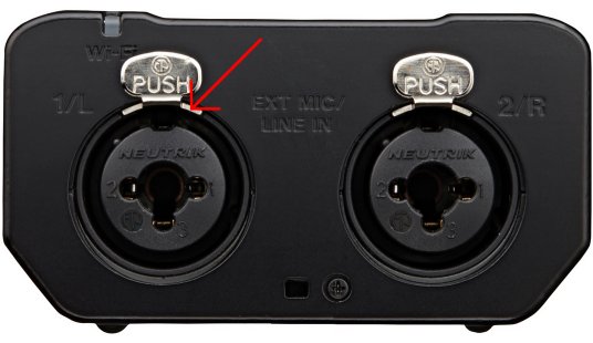

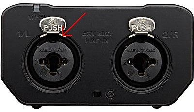

I, too, do not have a DR-44WL. But please allow me to add a comment in the hopes that it will be helpful.
It's unfortunate, and undoubtedly very frustrating for you, that you're having problems removing your connectors. Of course the Tascam's connectors are not made by Tascam, they are made by Neutrik. Neutrik connectors have a very good reputation, so it seems statistically unlikely that your recorder would have two connectors that are both bad. If the connectors themselves are actually good, then perhaps they are somehow mounted a bit too deep in the body of the recorder, so that it's difficult (or impossible) to depress the "PUSH" tabs all the way. It is also possible that those "PUSH" tabs have gotten bent slightly, so that when the tab is touching the body of the recorder, the mechanism actuated by the tab is not being depressed far enough.
I second Jay Massengill's suggestion. Perhaps you will have better luck, now that the inner portion of your connectors (with the male pins) have been removed from the shell. By all means, depress the "PUSH" tab as close to the shell as possible. Don't push on the end of tab that is above the logo. Push on the very bottom of the tab, immediately adjacent to the connector shell. If that doesn't work, then you might even try pushing on the thin piece of bright metal immediately beside the tab, using a small blade screwdriver. Of course you should push the moving part directly into the body of the recorder, and not toward the shell of your connector. I have found that this "last ditch effort" will work on connectors with bent "PUSH" tabs, when all else fails. (These were NOT Neutrik connectors, by the way, they were very old US-made connectors.)
Good luck!

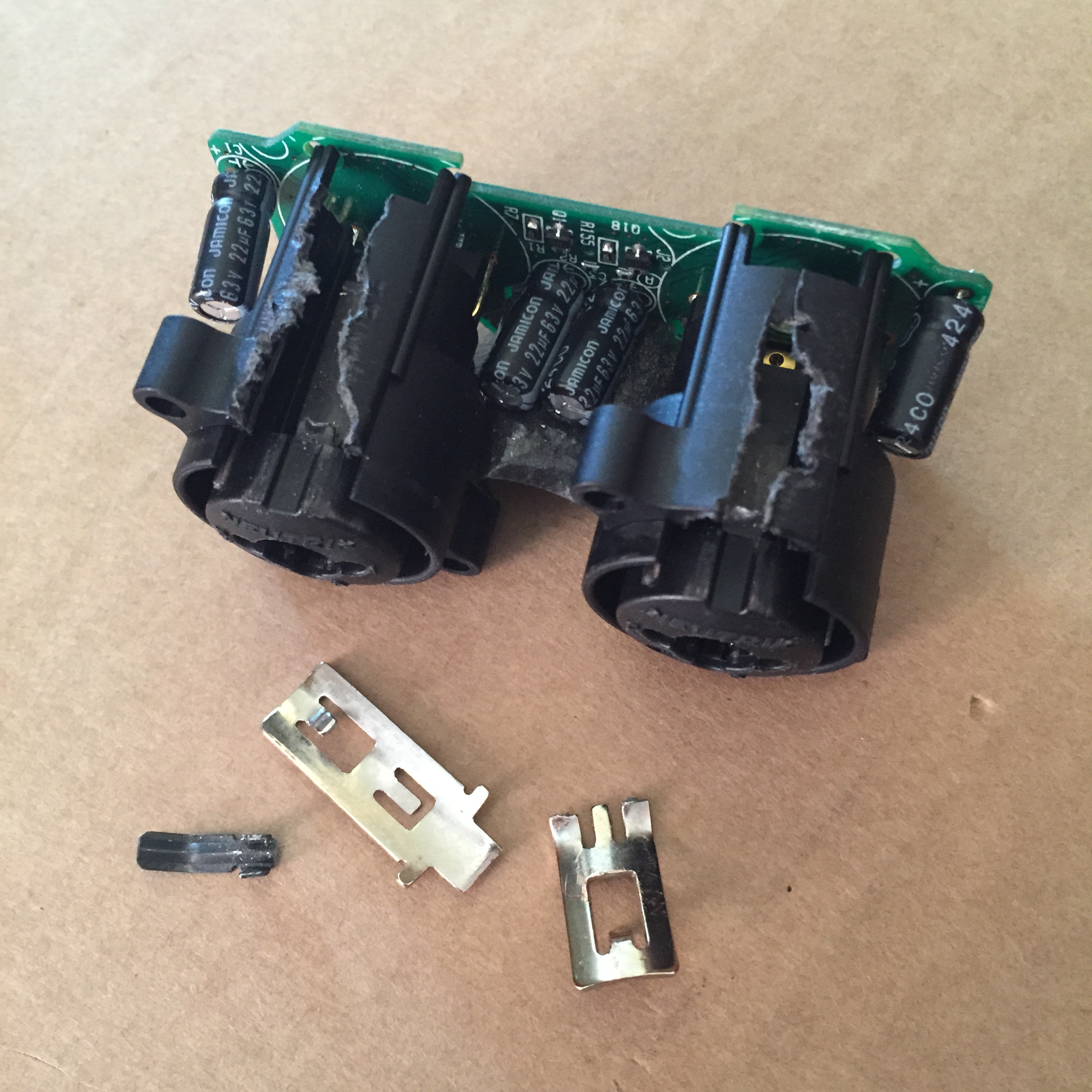

Old May 15th, 2015, 05:55 AM   #9
Join Date: Jul 2014
Location: Johannesburg
Posts: 44
Re: Tascam DR-44WL Review / Complaint
Update: After using the DR-44 recorder for a few months it's definitely a good replacement for the H4n. I rarely use the WiFi due to it's limited range but it has a lot of other features that work well, I wouldn't go back to the H4n. Unfortunately I was never able to free the XLR clips, I had to resort extreme measures by breaking them free. Once I snapped off the "Push" tabs it was easy to remove the cover & dismantle the recorder, everything comes apart in sections. Getting the clip mechanism out required that I tore away the plastic, this was a last ditch effort after I tried everything else. The XLR ports are still sturdy the broken plastic only housed the clip mechanism the rest of the port is unaffected.
Tascam DR-44WL Review / Complaint-photo-2015-05-15-13-03-02.jpg
