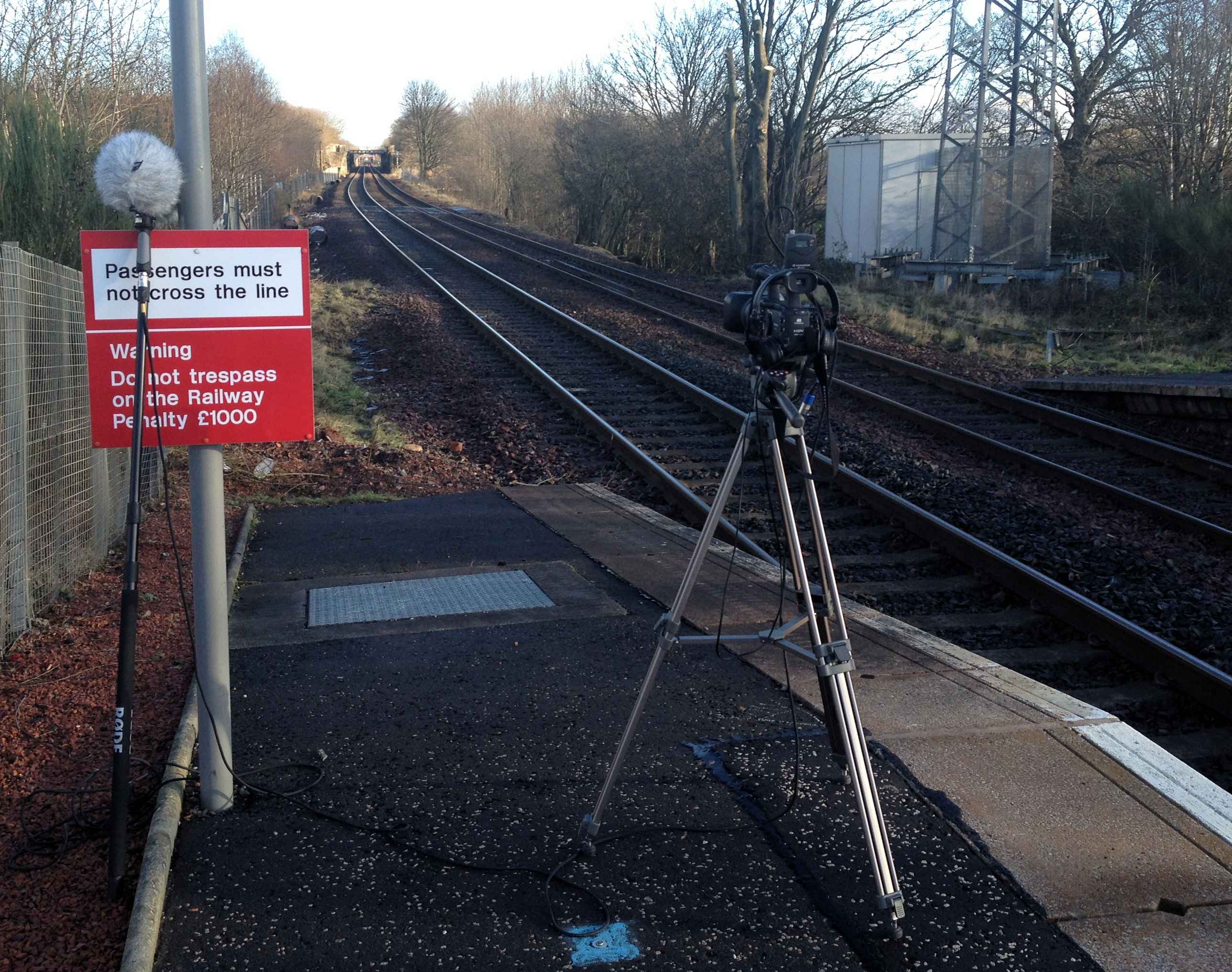

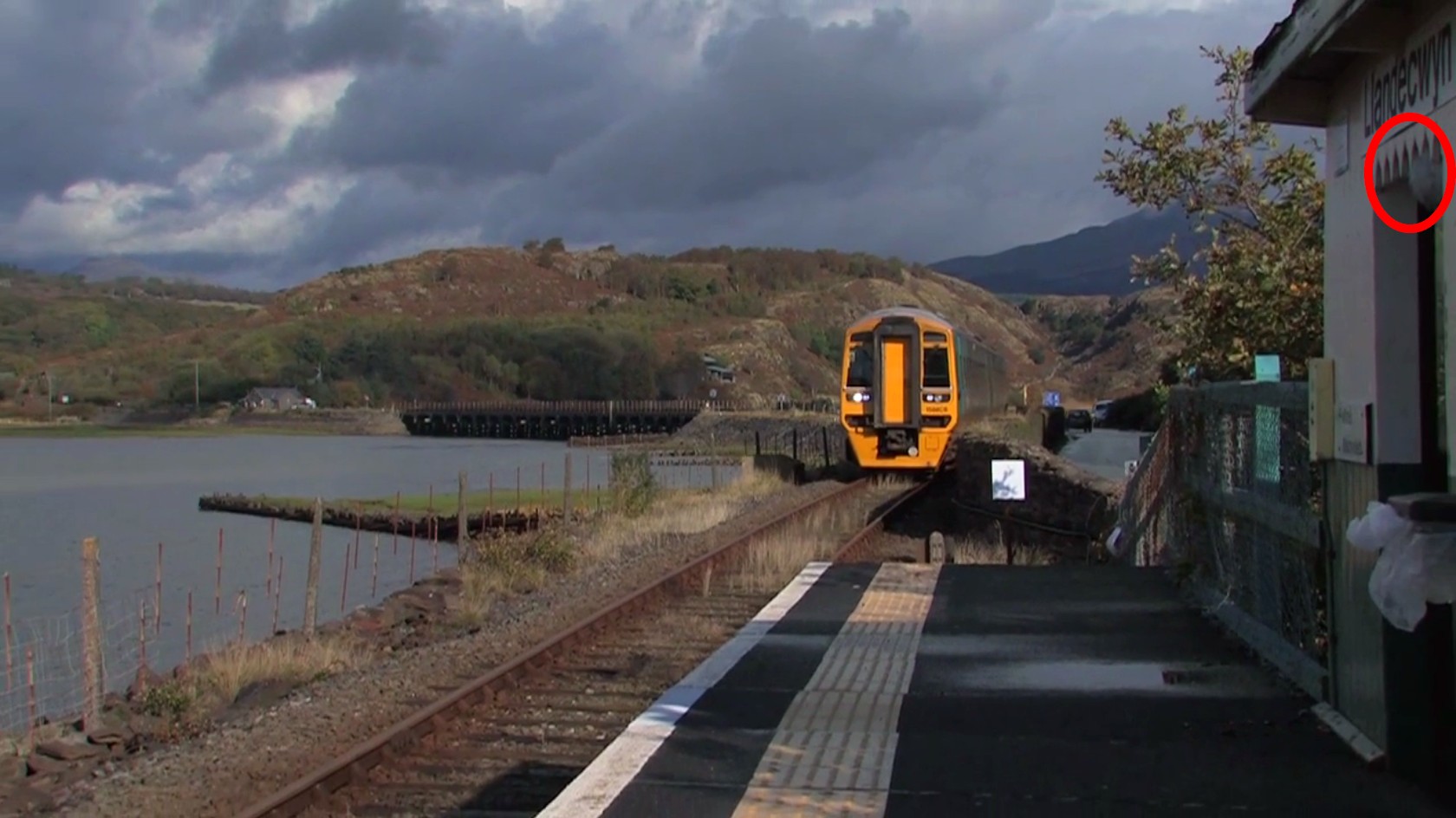

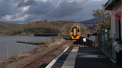

I find on-camera mics pic up too much extraneous noise, so I've taken to just using a small fishpole and blimp for wind protection. There's always some way of propping it up away from the camera.
The first pic at the bottom shows the setup that I use now, sometimes with an additional audio recorder or another remote cabled or radio mic. The Rode NTG-3 in the blimp is a big step up in audio quality from the NTG-2 I used before, and seems imperious to weather (I've had a few strange noises, quiet but audible, from non-RF biased mics in damp weather).
The second pic shows the blimp (almost) hidden in a station shelter for the video below. The audio was recorded in mono from near the bridge as well as at the station.
recording railroad audio??-rail_mic.jpg   recording railroad audio??-blimp.jpg
