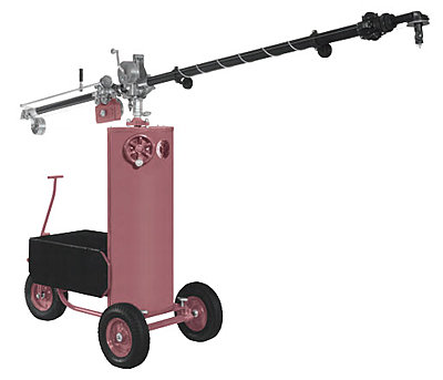

Or you could get one of these...
Jon Fairhurst

Re: Right mic for a studio??
I like that picture. Our studio is just a little small for it though. :)
Scott Holt is offline   Reply With Quote

Anybody who has held a long boom pole for many takes of a long scene knows the value of that photo. :)
I've done a number of interviews with a mic on a fixed boom, but it only works well for people who are seated and fairly static with a somewhat tight shot.In these cases, we spend time to setup the framing, lighting, seating, and mic position and then we do as many takes as needed. I wouldn't recommend this for a live broadcast.
