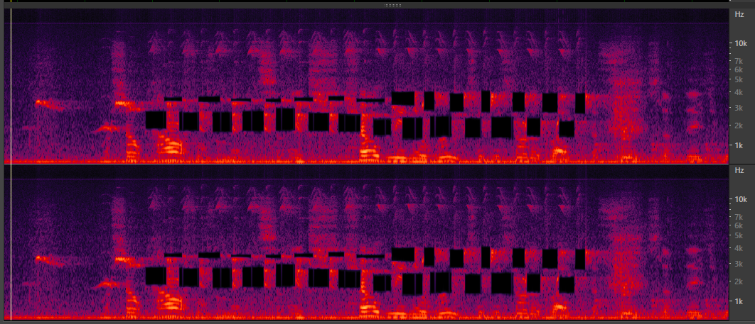

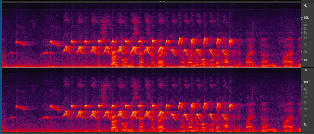

The extreme bird call sounds pretty much like a pair of alternating frequencies. But there is also a significant amount of "glissando" where the pitch glides from higher to lower. So my first concept of simply filtering out the two frequencies didn't work. I cut out "chunks" of frequency/time and it improved a bit, but we don't know what is "acceptable" to you?
I have to wonder why the overall signal to noise ratio is so poor? And why recording continued with such a very loud external noise. Were you monitoring the audio while recording?
extreme birdsong; last push on project-proc.png   extreme birdsong; last push on project-unpdoc.png
