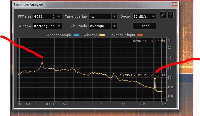

As to the HUM remover, I've found that the multiple harmonics can and do work very well; I can also de-group the harmonics; I also use the Spectrum Analyzer to nail a particular Harmo:http://www.dvinfo.net/forum/attachme...1&d=1442818399
I like your results and still think that RX is just plain VooDoo! - Oh, that's IT Engineer Terminology.

Graham - thanks for pointing out the analyzer and the harmonics...simplified my workflow
