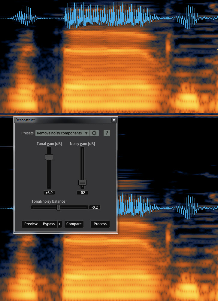

Pretty much the way Alexy suggested - using the Deconstruct module in Izotope 5 Advanced.
Honestly I had never used Deconstruct before so I thought it would be a good chance to learn it and I started working in my typical scientific way - in other words playing around with parameters with no clear idea of what they meant, just tweaking and listening to see if things got better or worse. Made a mess and had to start over half a dozen times (or more) but I kept at it and little by little figured it out and arrived at settings that seem to have done the trick
Now comes the hard part - working back from the result to an effective process that will get me there more efficiently.
Identifying offending noise by using spectral frequency display-bang-deconstruct-settings.jpg

Nice work, nice tool, also. Worth the considerable investment, I expect! Thanks for sharing.

With Deconstruct, you can always mix the dry and wet signals to your taste: they are phase-coherent.
