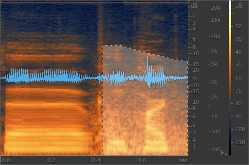

Hi,
I have a recording where there is a bang happening during the interview. I'm trying to remove it using Izotope RX but I'm having a hard time isolating the offending sound. Here is a screenshot of the spectral frequency display and I'm attaching that section of the audio that has that bang sound. Can someone tell me where on the spectral frequency display that sound is? Do you think it's possible to remove this sound? I have this banging happening in 3 sections of the recording. It would be nice to be able to remove it
THANK YOU!

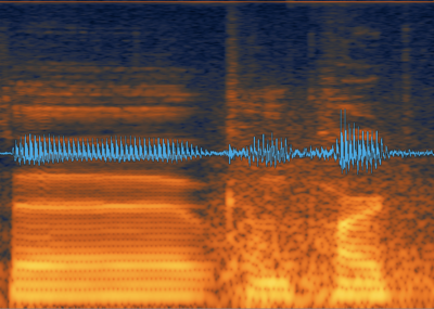

The bang overlaps speech on a spectrogram here, so it's not easy to get rid of it. You'll need to use Deconstruct instead of Spectral Repair.

I have listened to a few selections in your file. My first suspicion was the vertical line before my selection, but it turned out to be letter 'k'. Finally I have arrived at the correct selection.
When you have experience with audio, you can estimate the frequency content of any sound. In your case, it's a noise burst at lows and mids. And it has a considerable decay, due to reverberation.
