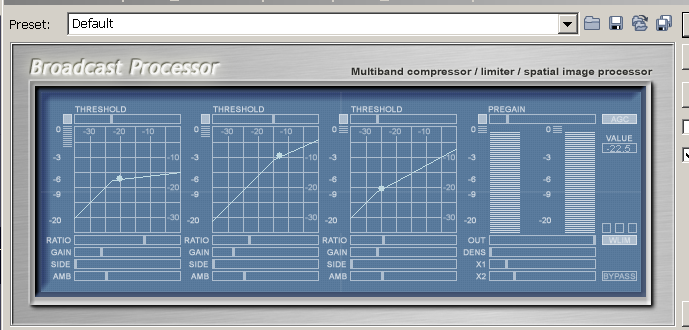

I would trythe JB 'Broadcast processor' plug-in which has a three-band compressor, limiters and auto-gain that is actually usable.. It may be a bit complicated for non-audio folks though.
http://www.dvinfo.net/forum/attachme...1&d=1455304506
