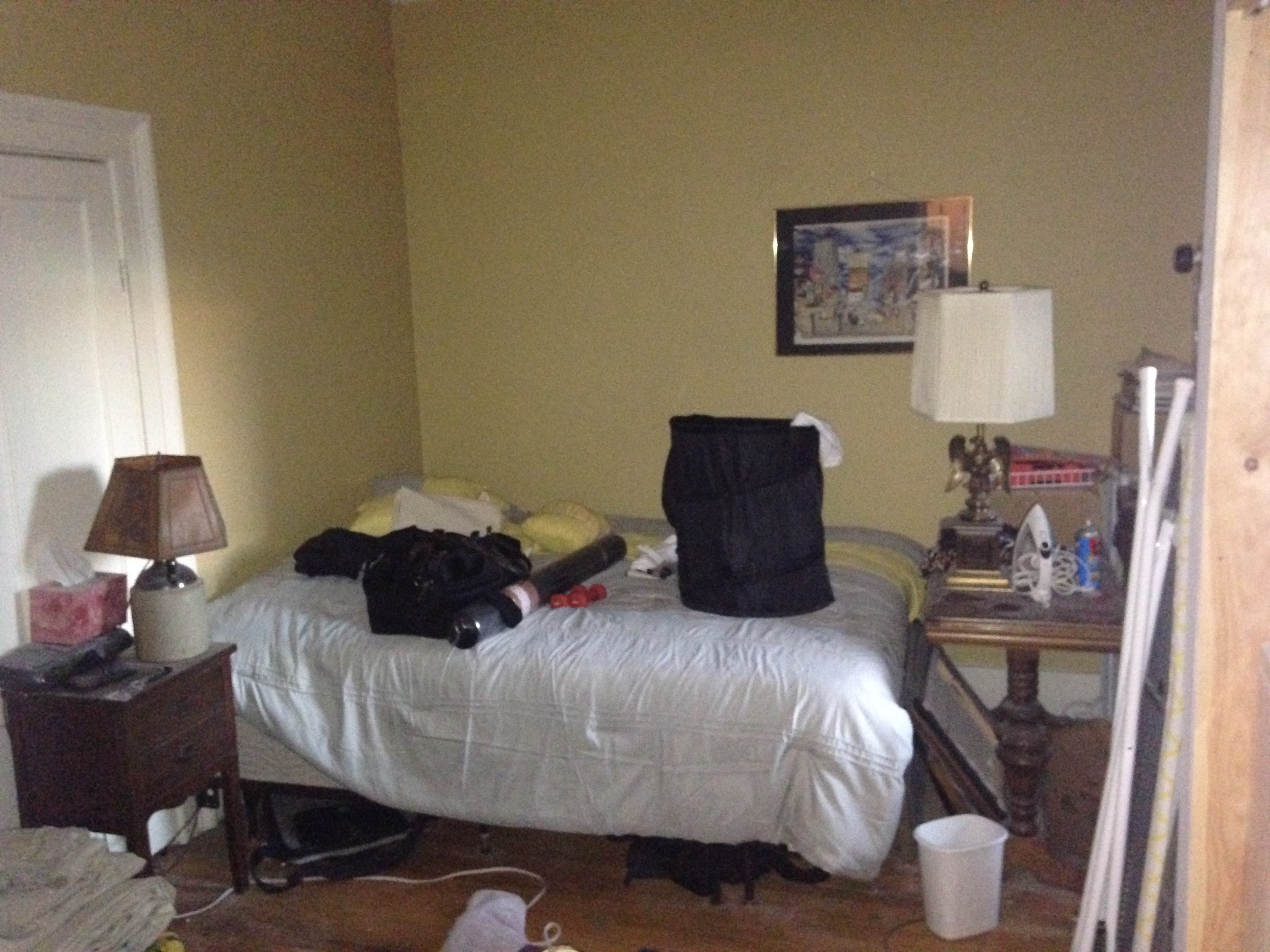

Picture of the room
Here is a picture of the room

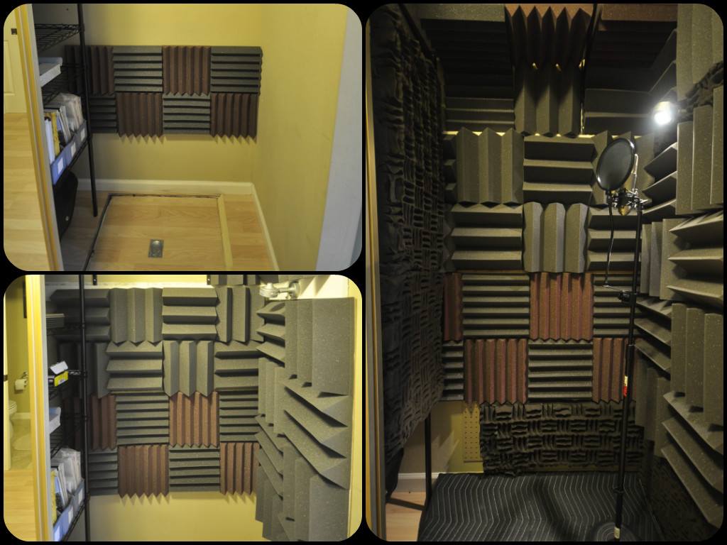

The cheapest way to record would be in a walk-in closet filled with clothing. You can even record under a few heavy blankets from the comfort of your bed. Obviously, it's not as comfortable for long sessions, but it would cost nothing, and keep the house intact.
I created a portable v/o booth within a closet, but it was mostly for outsiders coming in to record. If you're the only one that will see it, then looks don't matter as much as acoustics of the space.
