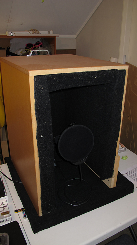

For what it's worth, here is a photo of a voiceover box I've used for a project I'm working on. There is a Rode NT3 Mic in behind the pop filter. The box is made of 18mm customwood and lined with 'audio batts' and the box sits on the same to isolate it from the table...
The wall behind where the speaker sits is pretty dead...
