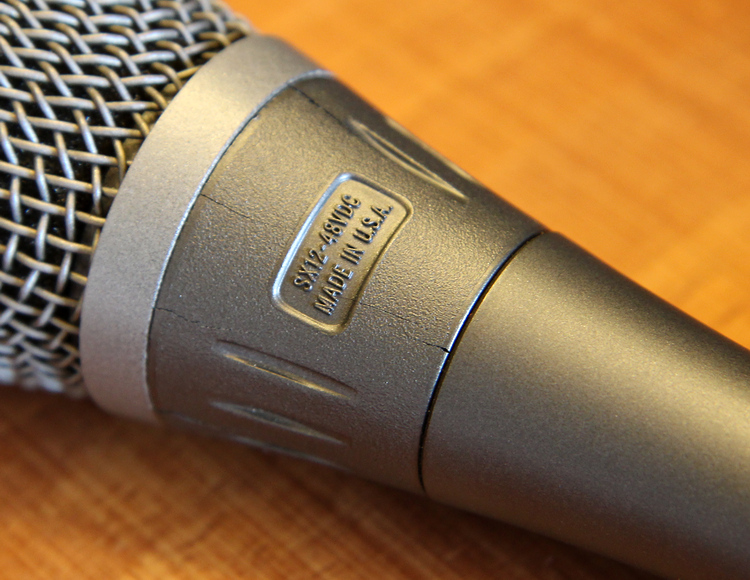

Simplex was the same as Phantom, although on some of their products the voltage varied, just a marketing name I guess. The M267 manual says 30 volts Simplex, but some of the early SM87 mics I still have from that time say SX12-48VDC on the imprint on the back of the mic (opposite the name plate side), so they could handle up to standard 48V Phantom. I've run them as low as 18 volts from an AKG battery supply and they sounded fine.
Hopefully the OP can tell us what he's decided to buy and bring us back out of the past.
Last edited by Jay Massengill; March 4th, 2016 at 06:25 PM. Reason: Memory failing, had to look back at the actual mic!
