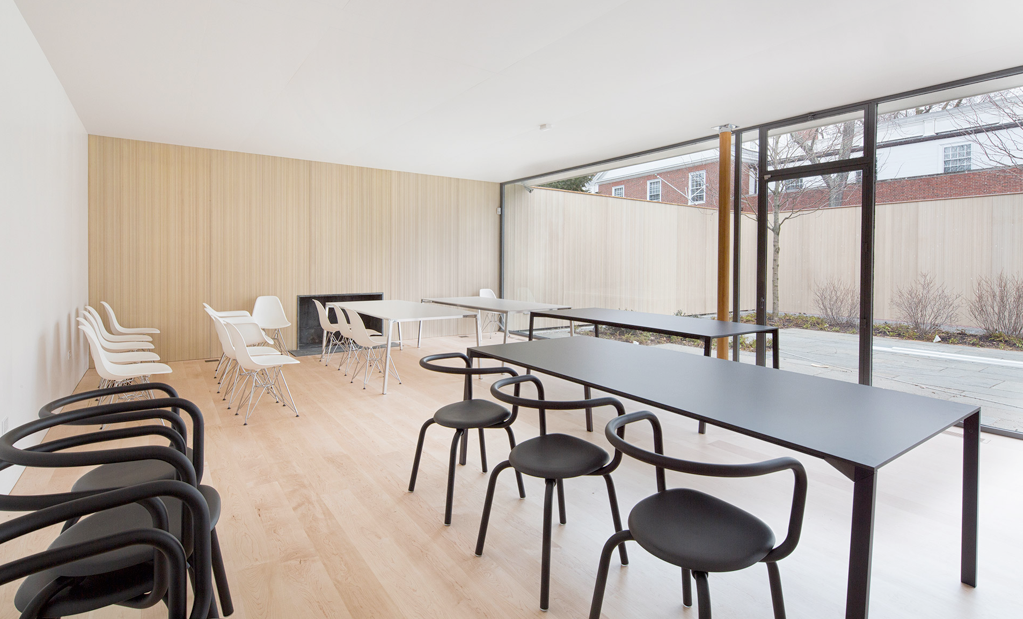

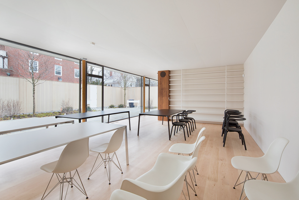

Here are two photos of the room this will be recorded in. The room will only have one or maybe two tables and there are things on the shelves now. I also believe there are vertical blinds on that big glass window. Not sure if the images help but any ideas what else I could do to that room to improve the situation? If I can convince them to use the sound blanket where can I put it so it's not in a frame? I will be shooting from where the fireplace is.

That's looks like a terrible room for sound recording! Hard to imagine anything worse. One glass wall, the other walls are hard, the walls are probably parallel (can't tell for certain from the perspective of those photos). The ceiling is hard, the floor is hard, there is not even any upholstery on the chairs. The room is even ugly and austere to look at, the chairs look terribly uncomfortable ... shoot the architect!
Cover all the glass with sound blanket, if possible cover some of the other walls as well. Carpeting on the floor wouldn't hurt.
I know, "I can't do that." So it's going to sound terribly live and audio quality will suffer. You cannot defy the laws of physics.
Mic each person with a lav, record them all on separate channels, mix accordingly. I know, "I can't do that."
If they want this just for archival purposes, it might be intelligible. Certainly nothing that I'd want to air at a later date.
Please excuse my bluntness. I've just gotten done with a client who ignored my advice, gave me a garbage recording, and expected me to "fix it in post." I made it better, but IMHO it still sounds sub-standard. I hate being associated with stuff like that.

Looks like an acoustical nightmare. Hard floors, ceiling, windows. You'll need quite few sound blankets. If you could rent a large piece of carpeting to cover as much of the floor as possible. If you could put some sound blankets on the walls and windows... but if you're relying on natural available light, the blankets will be an issue with that. In my experience, many of those type of rooms, the HVAC system can't be shut down in individual rooms, so extraneous HVAC noise may be another issue.

Yep I agree with Rick and Greg, an acoustic nightmare. Make sure that they are completely aware that the audio will not be good because of the room acoustics then at least they will know what to expect. If there are vertical blinds on the windows now then they may give a small amount of respite. You should see if you can angle the blinds to stop direct reflection of sound from the glass. You could also ask them if there are any alternative chairs available with soft backs to help reduce reflection.
I think that the boundary mics are the only type likely to give any sort of usable sound apart from the iimpractical solution of individual lavs. You could also try a reverb remover in post production, which I have had limited success with on some church sounds. Some eq tweaking in post may also help as a lot of room reflection is at the lower end of the voice frequency range.It may improve the sound at the expense of making it somewhat middly.
EDITED TO SAY you could put the acoustic blanket on the wall behind you for another minor improvement and I can't see them objecting to that as it will be out of shot.

I largely agree with Roger, with a few additional thoughts.
If the windows had actual fabric drapes, especially if they were lined, that might help somewhat. My experience is that thin hanging vertical blinds are insignificant; in fact they are often made of hard plastic strips which are acoustically reflective.
Yes, most room resonance is at the lower end of the speech frequency range. (Standing waves are largely to blame.) That specific room looks so live that I suspect the reflections extend to higher frequencies as well. I'll bet if you stood in that room and clicked your tongue, or said "tsk, tsk, tsk" you would hear distinct reflections of those high frequencies, too. That will smear the consonants and hurt intelligibility.
And Roger has an excellent suggestion: be sure to warn the client ahead of time, so that they are mentally primed to blame the room acoustics, and not you, if they are disappointed by the recorded audio.
