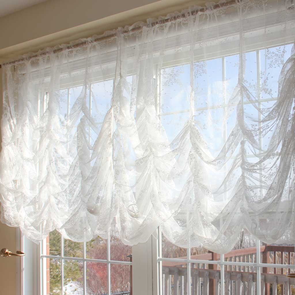

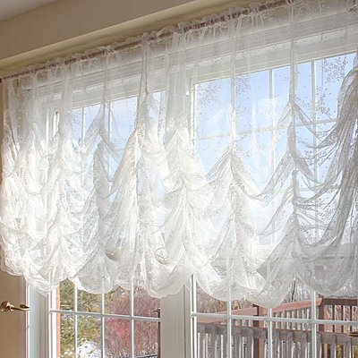

It is quite literally a trade-off between what the owners of the space will allow (aesthetically), what the decorator can provide, and how much acoustic absorbance you can squeeze out of it.
I had in mind something like this "Austrian balloon curtain". In a sheer colorless fabric, it would still let in a lot of light and not "block" the open feeling of the window wall. But all that semi transparent fabric is also semi-transparent to sound, and the spaces created by the folds would absorb some of the ambient sounds both traveling on their way to bounce against the glass, and as they reflect off the glass and back into the room (and your microphones). The rounded, uneven patterns would make an interesting contrast to the stark design/decor of the rest of the room. I am not a decorator, nor do I play one on TV, but I know what I like. :-)

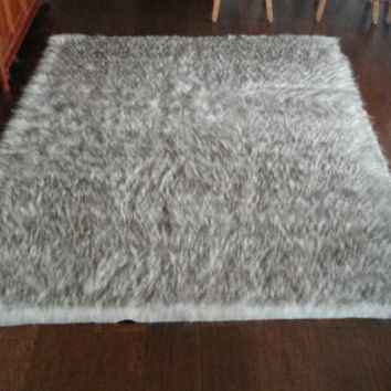

And I would lobby hard for hanging some kind of fabric feature (even if it is all white) anywhere on the opposite wall that isn't being use for protection. And for some of those big thick shaggy faux-fir carpets.

Richard, that's a very interesting curtain. I've never seen anything like that. Of course I don't get out much. ;-) It does appear fairly transparent, especially at the top where it's just one layer. Actually a rather nice effect: it lets you see the sky, yet somewhat blocks out the view of "man-made stuff" at the lower part of the curtain, especially if it hangs all the way to the floor.
I doubt that it would do much at the low end of the spectrum (which makes the room boomy), but it might help a tiny bit with the higher frequencies, and those are the ones that affect intelligibility. Still, the fabric looks very light in weight. Do you have any published acoustical specs for that kind of hanging?

Richard,
These Austrian sheers are very nice and an nearly every home uses them. The help to reduce the amount of stark daylight while still allowing for a view out the window.
I don't know why homes in the US don't use them more. Here is a listing of shears on an Austrian web site similar to Craigs List in the US: https://www.willhaben.at/iad/kaufen-...ne+wei%DFer%2C

Thanks Richard for showing the curtain. Unfortunately this design doesn't go with the original design of the house.
