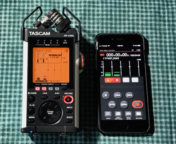

For good sound quality I'd prefer to run the mic audio signal direct to an external recorder and the Tascam DR-44WL has dual XLR inputs (plus two safety tracks) and can provide phantom power. Cam specifications for audio typically don't elaborate very much.
Originally Posted by Bruce Watson View Post
No wireless system, no matter how expensive, can equal a simple XLR cable for sound quality. Which is why the people who make a living recording orchestras on location own a lot of XLR cables, but no radios.
The Tascam is not a wireless recorder.
There are several advantages to using a recorder near the mic, one of them being a short Mogami will work fine so one doesn't have to string a lot of cable, especially when early arrivals are walking around. Personally, I do not like my cables being walked on because of the potential for damage. In an auditorium situation where a cable might be run from the stage to the rear of the building, depending on how it is set up, there is the potential for a cable to get trampled on. With a recorder taped to the mic tripod it makes for a really easy, clean, and neat setup. That's why I mentioned the Wi-Fi capability and it's a personal preference so "your mileage may vary."
The other thing I liked about the Tascam was the ability to remotely stop and start the recording between clips as it makes for easier syncing in post. Less effort to find which clip to match the audio with.
Picture of Tascam with Sennheiser ME-66:
