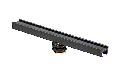

Hope the video above helps, I created it after getting a ton of calls on how to mount the Sennheiser receiver upon opening the box for the first time.
Not sure how "True" the statement from the Sennheiser rep was. For sure it helps keep the antenna from touching bare skin. I've been mounting belt pack receivers like this for years now.
To the original poster, Rycote makes a nice shoe extension Rycote https://www.dvestore.com/rycote-0377...tshoe-adaptor/

Thanks Guy and that rail is what I also use to mount my twin G2 as well.
