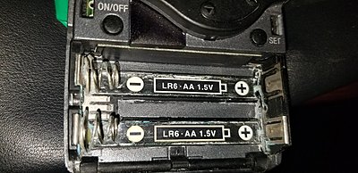

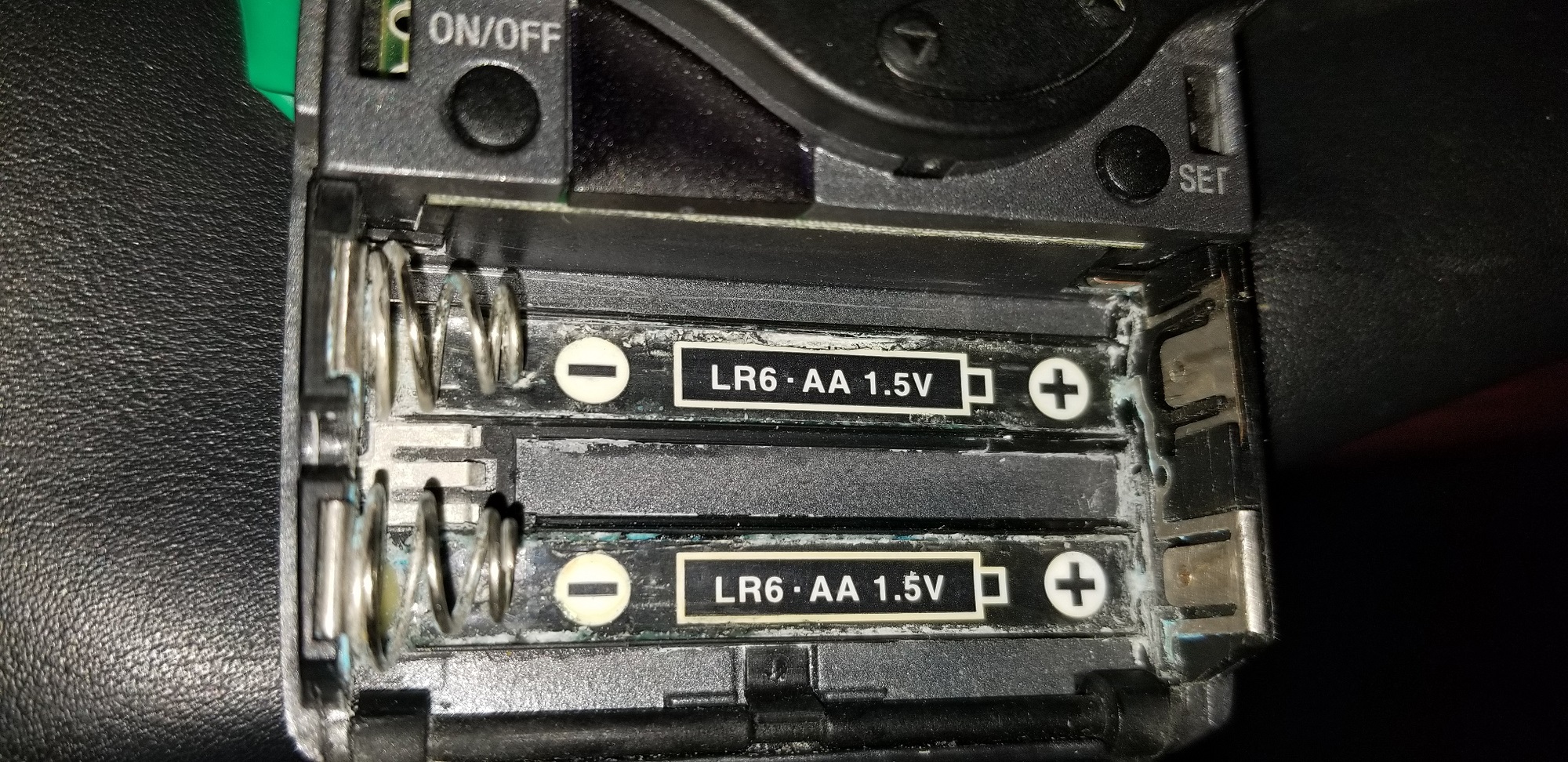

There does look to be some crud in the battery compartment and one of the 'positive tabs' looks like it is flattened too far and should be bent outwards a little? But the unit hasn't really been touched since we left the room where the shoot was. I just left it in my office at work overnight and now it powers on.
I'll clean up the battery compartment and put it back in service but it is working as is now, just not on Sunday. Ugh!
