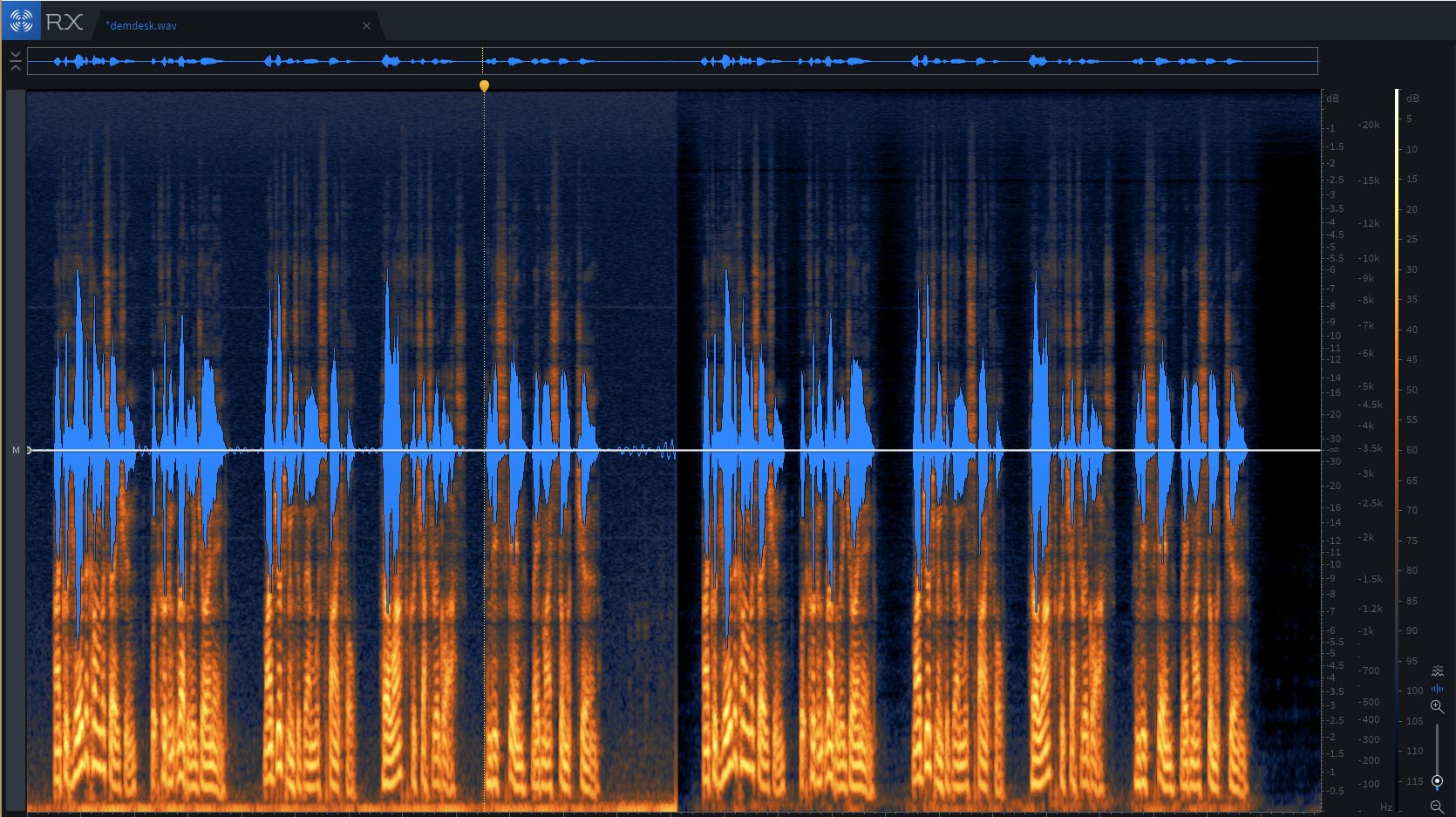

Anyway, I've attached a spectrogram of the audio file from within Izotope RX7 for whatever you can get out of it. What you can see in there is also reflected in the zipped mp3 file that is also attached - the supplied demo audio followed by a copy of it with the "dialogue isolate" plugin applied in an effort to clean out non-vocal sounds.
What I'm hearing in the original audio that is bothering me, I can only best describe as a plastic sort of nasality when you are speaking. You'll need to listen to the before / after with some headphones as it's a comparatively subtle thing. I'm suspecting that the only way forward will be a better / non-plastic microphone. Others here may have a better idea.

Thanks Andrew, I haven't clue what I am looking at in the spectrograph. However, I suspect that I will need to to get a lot better. If you would point me in a 'learning direction' plus a couple of clues, I will try to make sense of what you have sent.

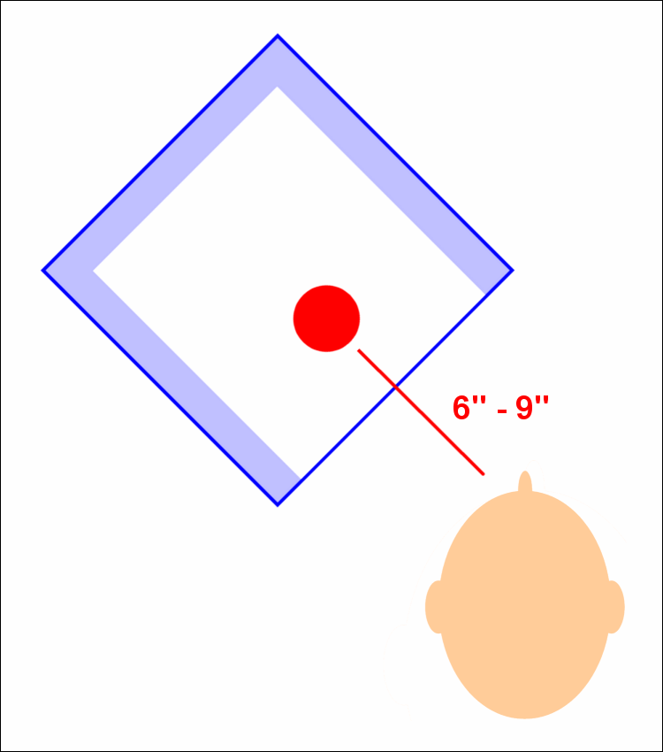

Re: Need guidance on quality and equipment
Thanks for the images, they are very helpful.
To be sure I understand the mic enclosure:
• The folding canvas bag seems like a good idea. The canvas won't cause any reflections back into the mic, and it holds the foam squares well.
• Is there also a foam square in the back of the bag, behind the mic?
• Do you also place foam under the bag, so the bag is not sitting directly on a hard reflective surface? (You should try to avoid secondary reflections e.g. from your mouth to a hard desktop to the mic. Those will cause phase problems with the direct mouth-to-mic signal.) "Ideally" the mic should be on a floor stand, same height as your mouth, not near anything reflective, e.g. not near a hard desktop.
• I suspect that placing that much foam in close proximity to the mic could alter the directional pattern. However, if it helps deaden all the room reflections, it's a small sacrifice.
• I think I would try *not* having the foam-with-hole in front of the mic. Leave the front open as much as possible.
I've cobbled a sketch to clarify the desired position of mic to your head. If the mic is off to the side, not only will it eliminate real "pops" but it will not "see" clear to the back of your throat so this may reduce some of the mouth noises. Of course the mic should be at the same elevation as your mouth. Honestly, I tend to work about 3" - 4" from the mic, but I don't have that box to contend with, my mic is on a boom. It's hard for me to imagine where the copy will go when you are dealing with that box.

Just updated my previous post with a sketch.

Thanks Greg, not wedded to the box, it has been part of the evolution. Sunday is a house clatter day, so doubt I will get much achieved. I will run at least three tests in my duvet fort: no box, open box and closed (with hole). If I can get a good sound without it, it would be much easier. I think I have kept a greater distance from the mic to reduce mouth noise. Ordered biotene mouth spray.
