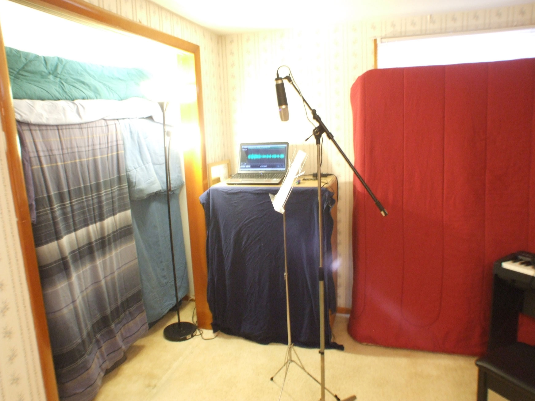

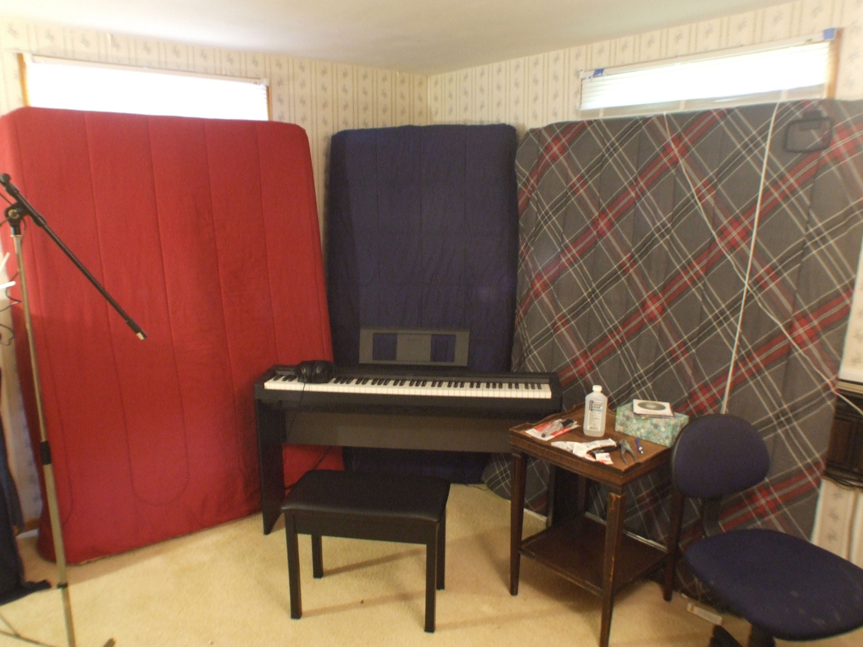

Here are some quick photos of a "COVID home studio" I threw together in a few hours so someone locally could record voice tracks at home. Luckily the room was carpeted to begin with. (Note the alcohol and disinfectant wipes on the table beside the keyboard.)
This was a spare bedroom, so fortunately we had a supply of mattresses and quilts. I stood up a mattress covering each of the two windows; this will slightly block outside sounds (luckily this is in a quiet neighborhood). Then I placed another mattress in the corner between the first two. For good measure, I draped quilts over all three mattresses. Most importantly this will deaden two sides of the room so will cut down significantly on reflections.
The talent stands about six ft. from the nearest hard surface, and faces toward the dead corner of the room. This is nowhere near the mid-point of either axis of the room, so it avoids possible problems from standing waves. Copy sits on a conventional folding music stand, so no hard surfaces there to reflect the talent's voice. The mic is on a boom, it's perhaps 30 degrees off the central axis of the talent's head, so pops are not a problem.
Note that the mic is facing into a closet (which is behind the talent). This is the mic's most sensitive direction (it's cardioid) so it's important to reduce unwanted sound from this direction. The clothes rod in the closet is draped with quilts, and the upper shelf is loaded with quilts and pillows. Thus the mic will pick up very few reflections from this area. The mic's back side (its least sensitive direction) if facing the corner between the windows; this may perhaps slightly reduce pickup of any outside noise.
The mic is USB; the headphone plugs into the mic for zero-latency monitoring. The laptop w/ editing software is within arm's reach of the talent, sitting atop a dresser. A heavy blanket is hung on the front of the dresser, and hopefully should help with at least high frequency reflections.
