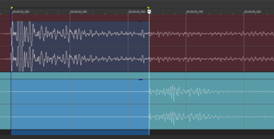

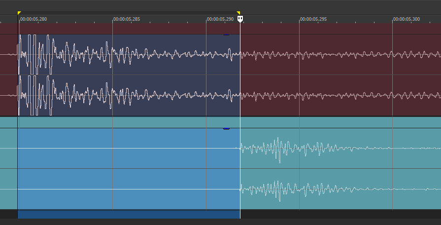

One thing I've found is that the alignment of audio tracks to the video in my cameras is generally off (early), so any automatic method that uses the audio tracks would only be approximate. I would end up fine tuning the sync manually, which is my normal workflow anyway.
The attached photo shows how much I've offset the keeper audio (bottom) from the camera audio (top). It's only 12 milliseconds, but that was enough to look odd to me. It might not matter much with dialog, but with music 12ms makes a big difference.
