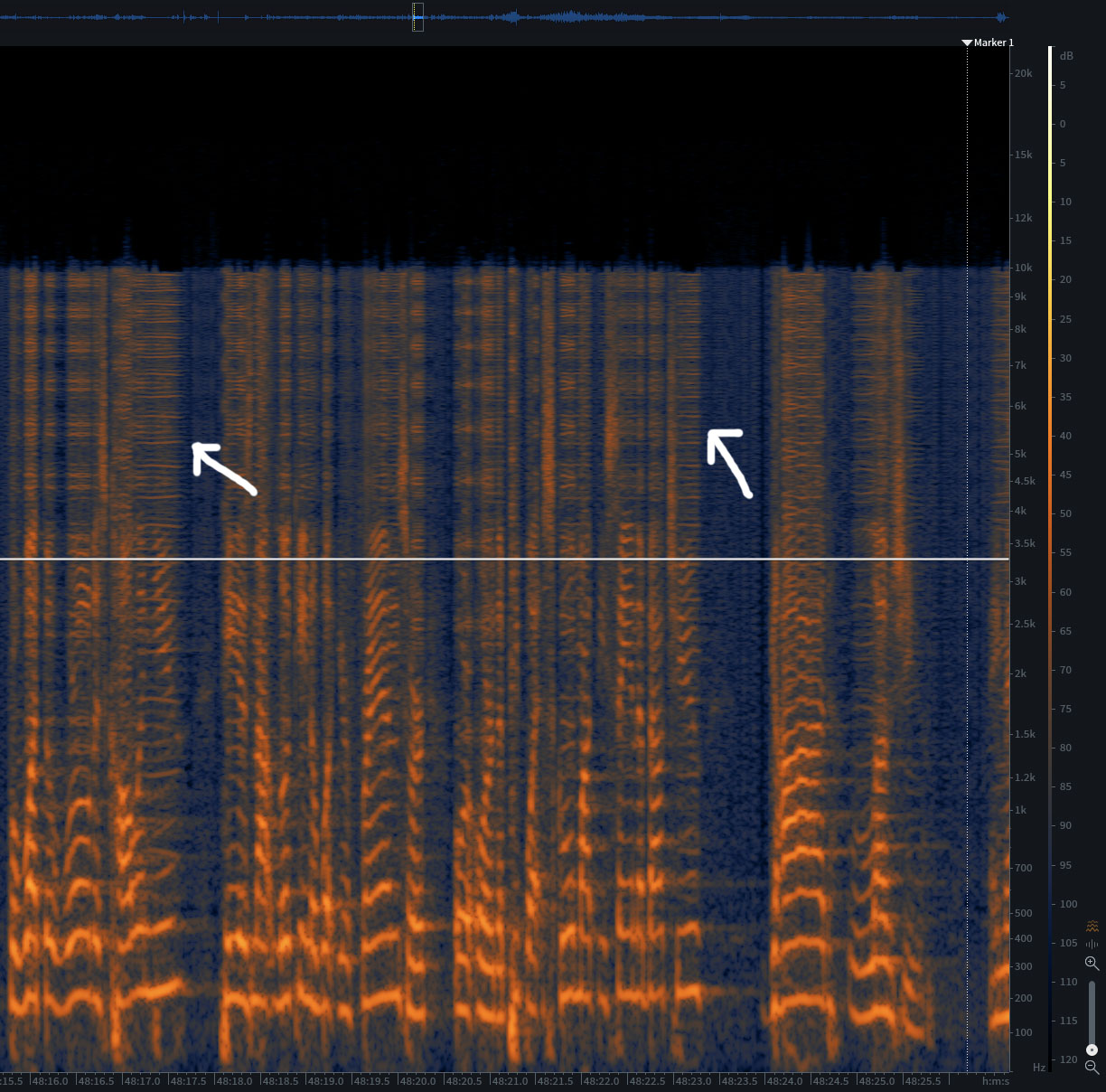

Have a look at the image at full size and you will see some banding in the upper frequencies when the guy is talking, during which the interference which seems to happen as his speech is peaking. It's always interesting to see it in a visual representation, this one being from Izotope RX.
Also interesting to see that the issue started at about the 45 minute mark.

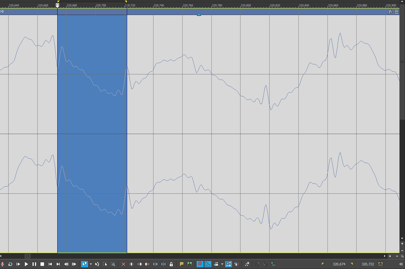

Confirming this is occurring in the digital domain, the artifacts have a regularity to them. They appear every 48 samples (exactly 1 millisecond at 48 kHz sample rate). It's an alternating down-up-down then up-down-up pattern.
It sounds like a buffer underrun. If there's a place to adjust your buffer size, you might try increasing it. Also, make sure everything's running at the same sample rate.
