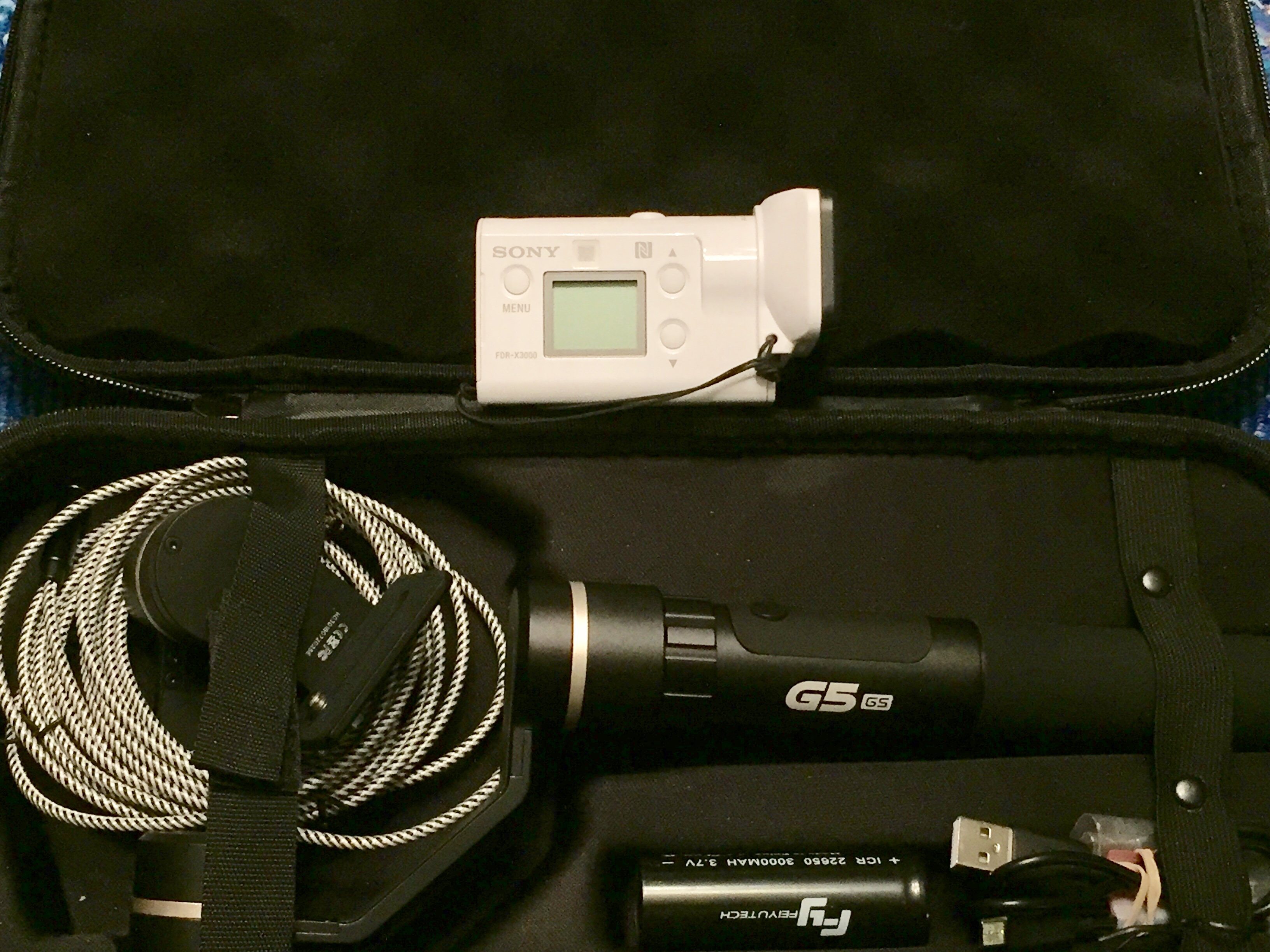

The braided sheath 3.5 mm cable option has one advantage and that is flexibility. I got a couple of them for use with a sport cam (Sony X3000) and an external recorder, while the cam was mounted on a gimbal. The cable had to be light-weight and very flexible so it wouldn’t impact movement of the cam on the gimbal.
To achieve a high degree of flexibility, you know that the internal conductors have to be really fine wires, so, given that, the qustion is, how robust is the cable? The concern “will work without problems?”, then just addressing the cable itself and not the end terminals, the answer would be “Yes”, but conditioned based on the quality of the audio and now long it would last.
If high flexibility and low weight is not a priority, or must-have, if it were me, I would spring for a more robust 3.5 mm cable that would likely last longer and provide a cleaner signal. I think the cable itself is delicate, and that is just a personal opinion. For the use I'm putting it to it works very well.

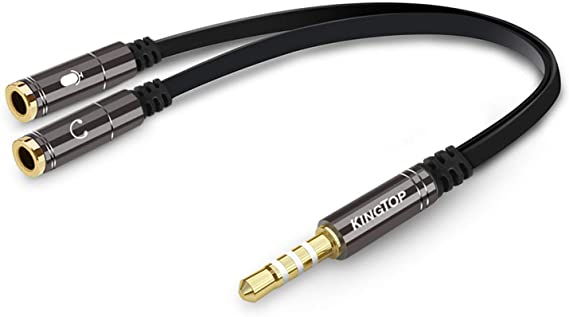

Re: Advice about an extension cable for microphone of my camera
I recently bought a China made Y-adapter on Ebay for a two dollars. It has a single 3.5mm TRRS plug on one end, and two 3.5mm female jacks on the other, one for a mic, the other for headphones. It worked as it should, If you will using it a lot, better quality adapters can purchased from the usual smartphone suspects.
Now I understand better.
Do you have a pic of that cable please?

<i>Do you have a pic of that cable please?</i>
Advice about an extension cable for microphone of my camera-61tvogjufkl._ac_sx569_.jpg
