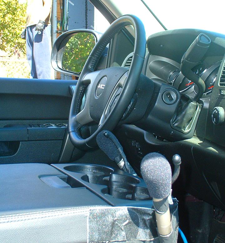

Aside from closing the windows and shutting off the interior A/C or heat fan, a high-pass filter can help to attenuate the low frequency road noise.
I usually mount a lavaliere or boundary mic on the person's sun-visor I have also used, hyper-cardioid mics mounted on the center console pointed up towards the talent.
