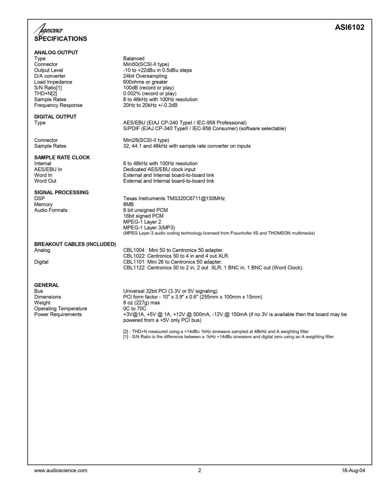

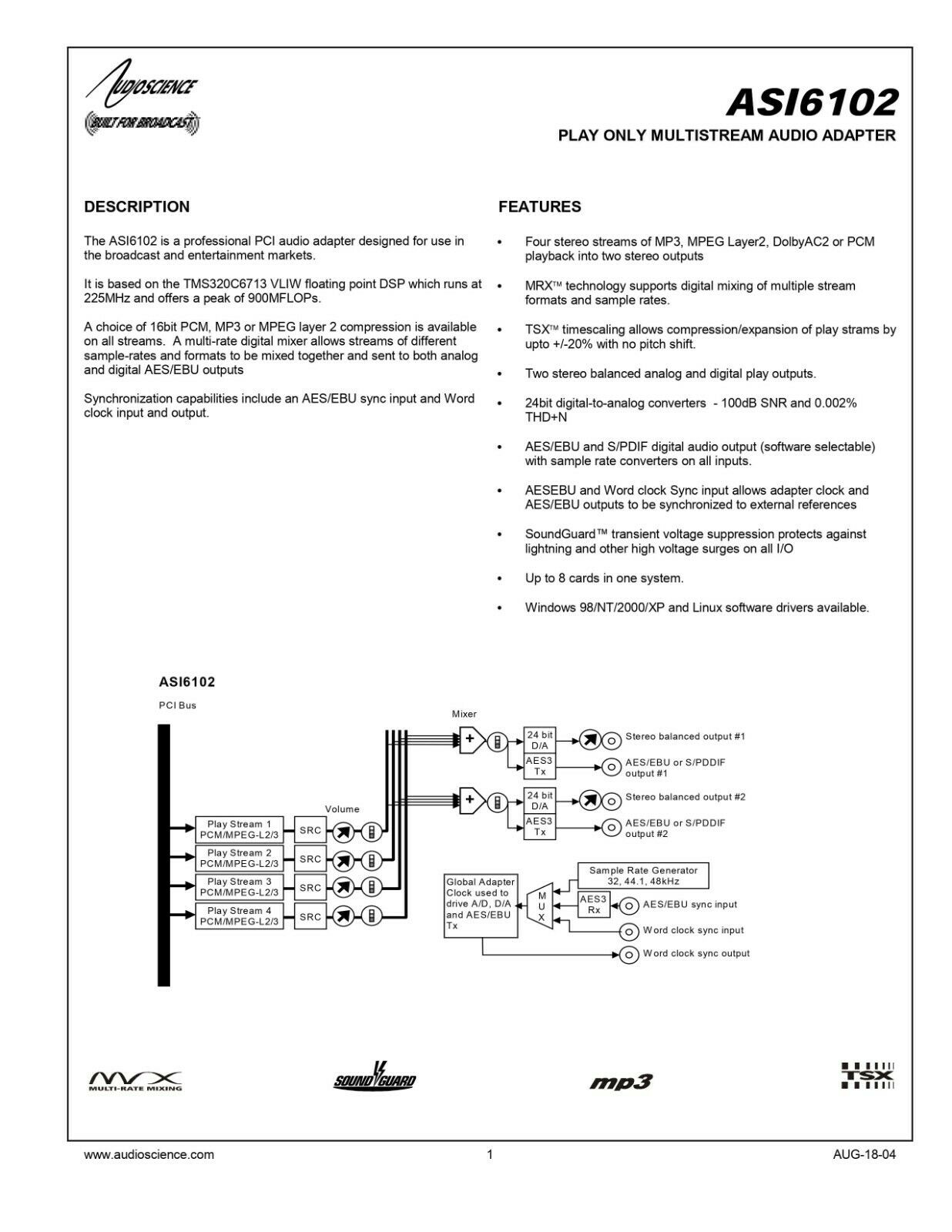

All is not lost though. I hunted around on eBay and found the following. It's an AudioScience ASI6102 Play Only Multistream Audio Adapter MRX TSX PCI Card. US$60.00. Is it worth $60 to decode them? Your call I guess Greg. These cards have four channels of analogue audio out. See pix below. It looks like the latest drivers available for them are up to Windows 7.
Depending on the card model number, like the eBay ASI6102 PCI card I've listed below it looks like you would need driver version 4.04.14 as it is the last driver version to support the ASI60xx, ASI61xx and ASI62xx cards.
Driver downloads here:
AudioScience-Windows Drivers Old
Please note, version 4.04.14 is the last driver version to support the ASI60xx, ASI61xx and ASI62xx cards.
Driver check here:
http://audioscience.com/internet/pro...sheet_win7.pdf

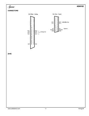

Dolby AC-2 codec-as16102-adapter-01.jpg   Dolby AC-2 codec-as16102-adapter-02.jpg

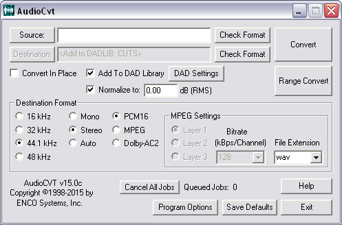

I contacted ENCO and this is what I heard back from one Jeff Shelp in Support. Just waiting to hear the price as my local ENCO rep wasn't even aware the software existed.
Chris Young
"Hi Chris,
As part of our DAD automation Program, DAD can convert AC2 files to PCM16
IMAGE, see below
AudioCvt
Audio Convert is also an external program that allows the user to convert audio files and inject them into the DAD Library or convert existing Library cuts to another audio format.
Audio Convert is also an additional purchase option."
