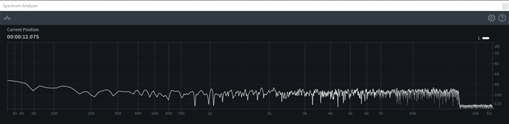

Nasty! It’s intermittent and the volume is stable. Doesn’t “sound” like a grounding issue. No hum. I’ll test later in RX9 to determine if there’s some harmonics/hums that could potentially point at external/internal forces at hand. If you test record it in different environments, do you still get it? Is there any switch of stream from analogue to digital that could require resampling? Resampling can throw up crackling type anomalies. What’s wrong with you just replacing it? Expense or not wanting to do so IF there is a solution?

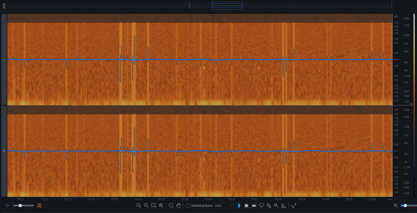

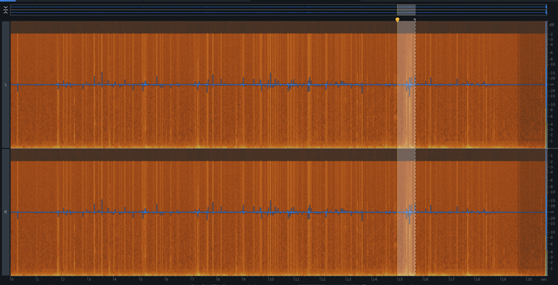

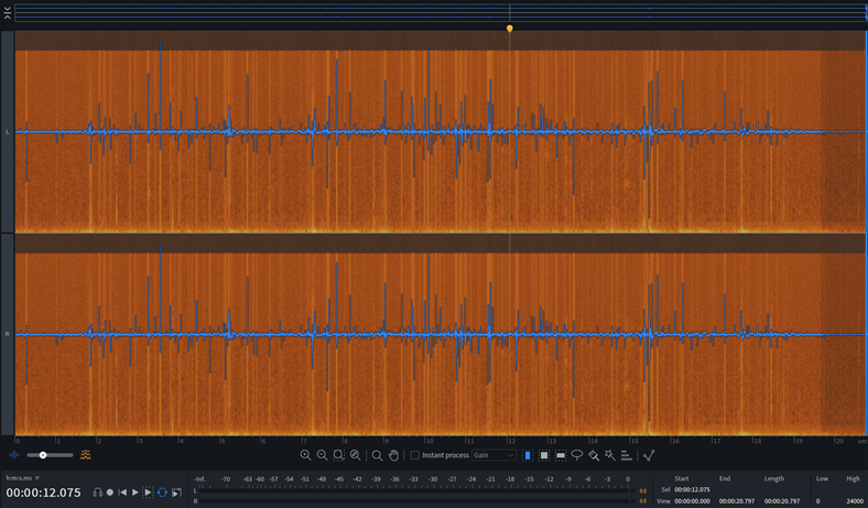

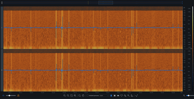

OK, some RX9 Advanced screengrabs. No Hums of particular concern/worries. The crackles Invert each other, could be an indication of grounding fighting? If you do a lot of paid work, get a cable tester. In a sense you've tested against a known working cable, so test that too!
Could you get me the output from your GOOD Cable?
Interesting.
