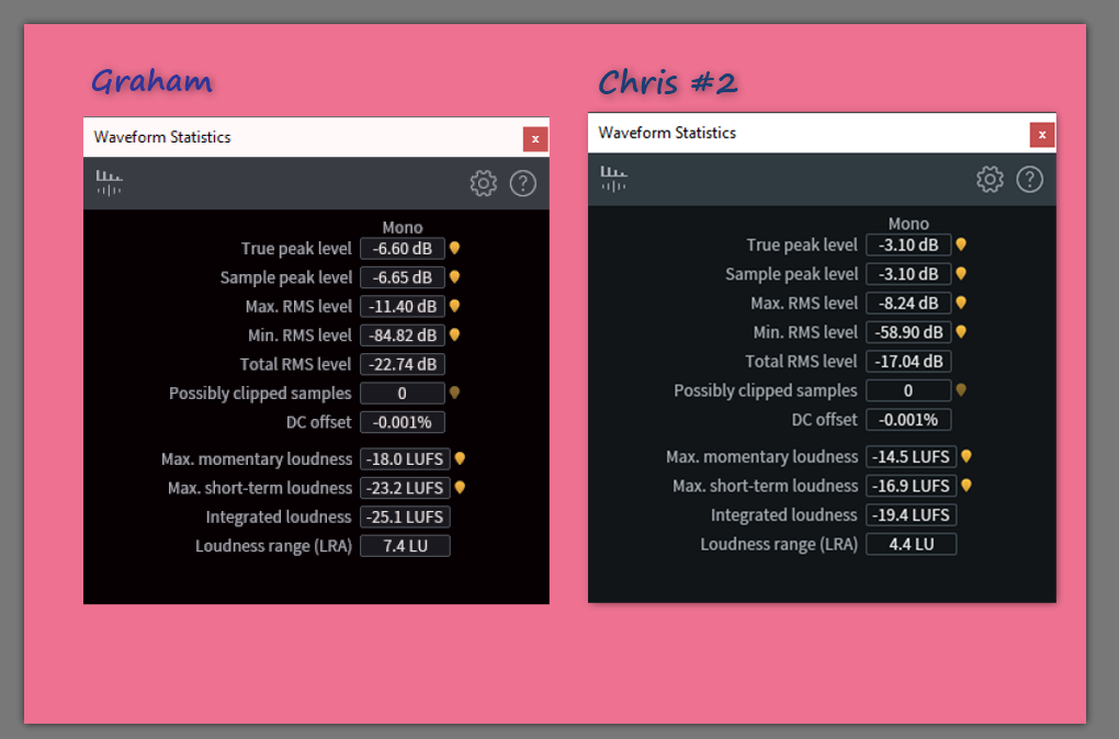

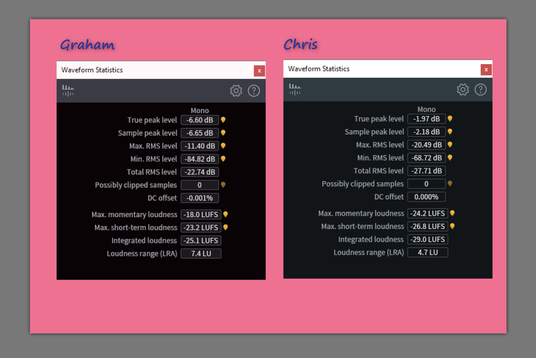

A quick clean-up attempt. With a bit more time, could be improved.
Chris Young
Chris, nice job. I took the liberty of running your sample through RX Waveform stats. What do you think?:
https://www.dvinfo.net/forum/attachm...1&d=1672467470
Old December 31st, 2022, 03:14 AM   #39
Location: Sydney Australia
Posts: 1,622
Re: What is this noise and how to remove it?
Yes Graham. I like that yours has more bottom end and sounds fuller. I found when I first tried giving it a bit more bottom end, it muffled the recording somewhat. Your recording made me revisit my first attempt.
To get to the result of version #1 that I uploaded, I just duplicated track #1 with the file on it to another track, track #2. I ran noise reduction on track #1. I then ran noise reduction on track #2.
Then I inverted the phase on track #2. This gave me 100% signal cancellation with track #1. No sound audible as the two tracks cancelled one another out. I then offset track #2 by three (3) samples to the right. This brought my tracks back to being audible. Obviously, though, sounding thin due to the opposing phase cancellation of track #2 vs track #1. On the master bus, I then added a DeEsser at 5506Hz with a -30dB threshold.
On this #02 version upload, again on the master bus, I added a +7.5dB boost @ 167Hz plus boosted the overall gain to peak at about -3dB. In other words, to levels I'm more than likely to use during an edit. All of it done 100% in Vegas Pro 17.
The inverted phase cancellation with offset method is something I've used for years when having to try to extract reasonable audio out of noisy ambient room mics for example.
Chris Young
Version #2 can be found here:
https://www.sendspace.com/pro/dl/6ejypm
Well, thank you for saying. I always add gain to start with. A bit like in video seeing how much Gain I can add without video noise. So, I add GAIN in stages until I got a well-represented fuller SN ratio that I could use, then off to the Races with iZoRX10 Adv.
Yes, I cut my Audio teeth within the VP and SoundForge packages. Using much the same approach as yours. Dupe Tracks; Inversions and the NR package. However . . . . iZotopeRX came along and I haven't done any Audio correction within VP or SF for the last 5 to 10 years, only iZo - It is pure VooDoo!
Again I captured the Waveform statistics in iZo and produced this graphic for comparison:
https://www.dvinfo.net/forum/attachm...1&d=1672486153
