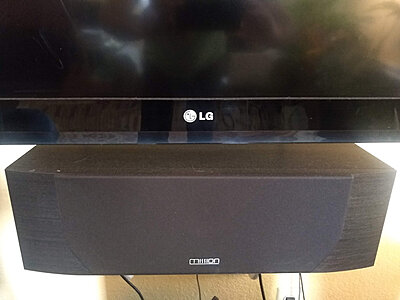

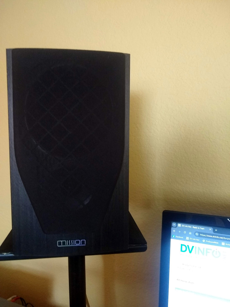

My earlier suggestions were a bit generic because I wasn't considering the specific equipment you had. Some of the Bose speakers of the type you seem to have were adequate for casual listening, but I wouldn't rely on them to make important decisions about sound quality. Given that, I do suggest replacing them. But I strongly recommend getting matched speakers, at least the front three. Many manufacturers make specific center channel speakers that go with speakers they make for left/right, different but compatible. The speakers need to have matching tonal qualities, and it's helpful if the sensitivity specifications are similar (so they play at about the same volume).
Attached photos are of my speakers. My rear speakers are currently not matched to the front, but I plan to replace them fairly soon to have a complete matched set (aside from the subwoofer).

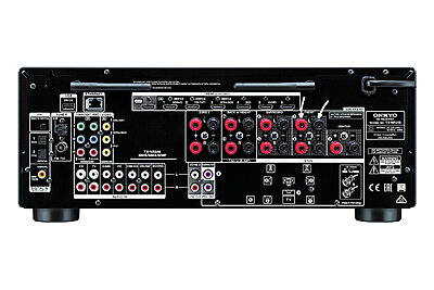

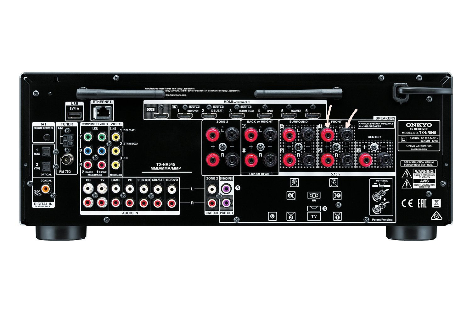

the new speakers will arrive in two days and I would like to ask a question about the connection to the Onkyo amplifier. When I plug the 2 cables of one speaker to L (red and black- look at the pic), is L the left of the person watching the TV or the left of the TV?
Then .... I will not use the central channel but out of curiosity:
If I wanted to do a test and have the voice come out of the central speaker, which Menu option should I choose in my Onkyo amplifier? Maybe should I choose "Surround"? Is this the only way I can get the narrative voice to come out of the central speaker?
Thank you.

Old November 22nd, 2023, 02:49 PM   #42
Location: New York
Posts: 2,044
Re: What do you recommend changing in my audio system?
LEFT is looking at the TV screen (or the front of the LCR speaker cabinets).
If you want dialog only in the center speaker, it would need to be mixed in 5:1 with the voice assigned to the center.only. What DAW (or video NLE) do you use for mixing audio?
If want to listen to a stereo mix on only the center speaker, you would have to disconnect the LCR speakers cables and re-connect the L-R speaker cables to the center speaker. Leaving the L-R speakers disconnected. No easy way that I am aware of with the consumer amp. Recording studios typically have six discreet channel feeds and power amp channels (or 5 powered speakers and a sub) woofer for mixing. The 5:1 mix is then encoded along with the video or encoded separately and 'muxed' in after the video picture file is rendered.

Old November 22nd, 2023, 07:17 PM   #44
Join Date: Feb 2015
Location: Lafayette, Colorado
Posts: 168
AllCh Stereo spreads a 2-channel stereo input across all the speakers. I would not use this.
Direct takes whatever format is given and puts it in the same number of speakers (2 speakers for stereo input, 5 plus the sub for 5.1 channel audio input). I would use this to check stereo mixes on a stereo system.
Dolby Surround "up-mixes" stereo signals to 5.1. This is what I would use to check my stereo mixes on a surround system.

Old November 23rd, 2023, 01:47 AM   #45
Location: Rome Italy
Posts: 689
Are you telling me I should use "Surround" to get the voice out of the central channel? But should I choose Surround on Onkyo even if I have a file worked with Edius in Stereo?
