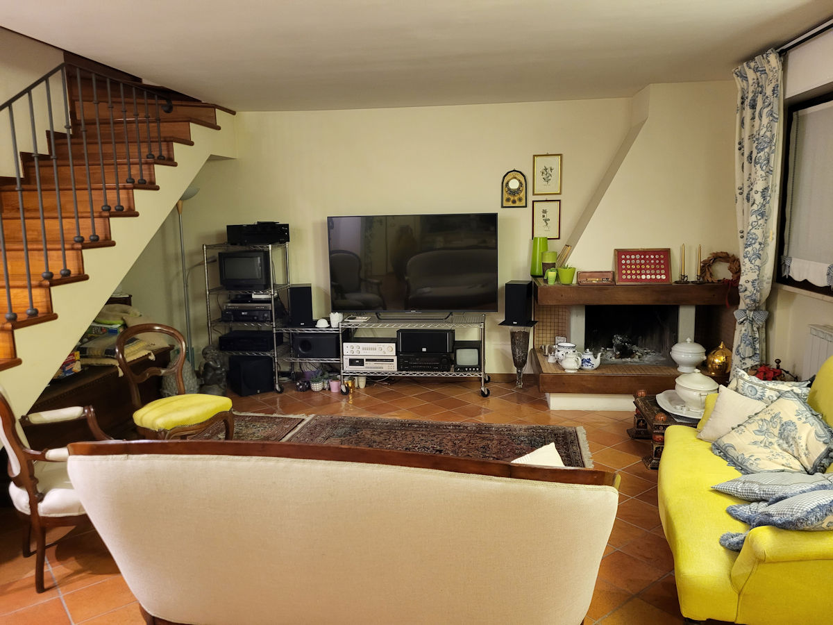

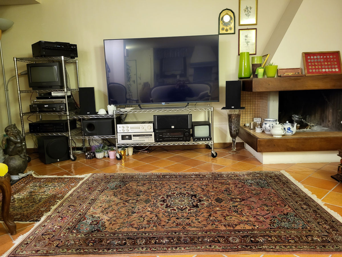

Old November 25th, 2023, 06:32 PM   #51
Location: Rome Italy
Posts: 689
Re: What do you recommend changing in my audio system?
Thanks for your suggestions. I attach a pic where you can see the location of my Elacs. I have also 2. floor rugs, one large and one small. Then who are the curtains on the right and 2 fabric sofas. Under the speakers I often have a carpet panel.
I am not able to find C SPREAD and ACCU EQ in the Menu anymore, where are them?

Old November 25th, 2023, 07:37 PM   #52
Join Date: Feb 2015
Location: Lafayette, Colorado
Posts: 168
I never make a AccuEQ test with microphone. I don't find the original mOnkyo mis. Is it important this test?
Perhaps if you have the center channel disabled you won't be able to access C SPREAD (because that gets done automatically without a center speaker). I don't know why you can't find AccuEQ. Hopefully it's disabled.
Your room has some positive and negative features. On the negative side, there are lots of hard surfaces. That will tend to color your sound by adding reflections. On the positive side, the intrusion of the chimney on the right and the stairway on the left probably break up some reflections. The curtains will help a little when closed. Note that the curtains and the rugs won't have any effect on bass frequencies. Those are likely to vary a lot depending on where you are in the room unless you apply aggressive acoustic treatment.
One area that could use some improvement is that the left and right speakers are a bit close together if the couch is the main listening position. The usual geometry is a nearly equilateral triangle. That might entail putting the speakers higher (with one on the mantel). If you did that then a slight tilt downward would be a good idea to keep them aimed at the listener.
Patrick Tracy is offline   Reply With Quote
