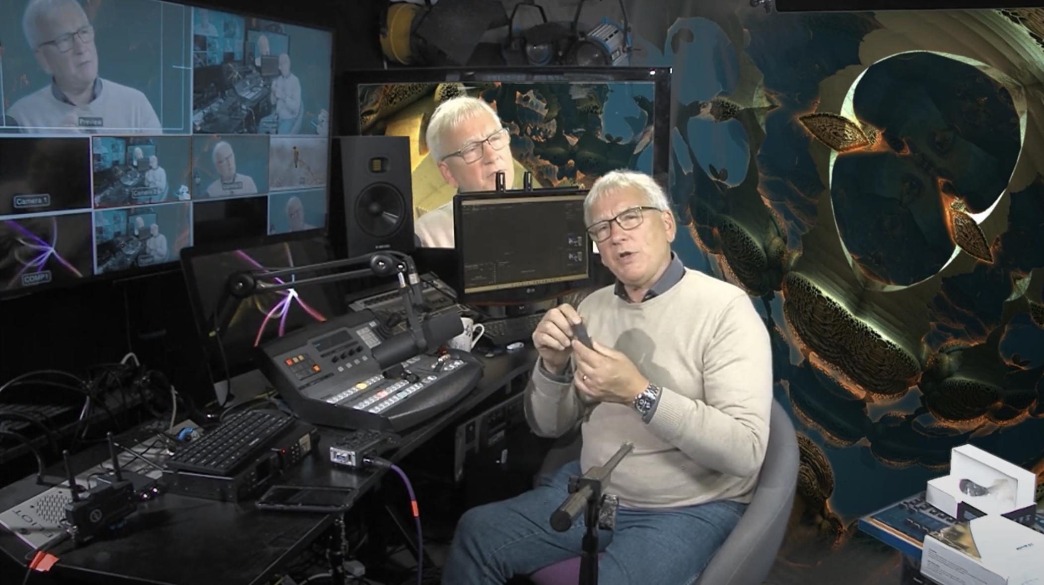

Ive done what you have done in my video studio. My audio studio sounded so much better with the 25 year old monitorsI know so well, and the video studio using passive 5” RCFs was fine but just hiding things, like hums and occasional colouration from reflections.
I decided to buy some active Adam 8” speakers for the audio studio because a friend had some and I liked the sound, BUT put them in the audio studio to replace the tired speakers there. Old 8” celestions. Not the best when new, but i know them so well. I found the Adams difficult. They sounded wonderful, but too modern, so i moved them to the video studio, which was a real success. Instantly more revealing of my occasional problems, and unexpectedly also making hiss more obvious to even my aged ears. Hugely better sounding and somehow, either side of my very large multiview screen, they do not sound like two speakers, but a proper soundfield. The old 5” speakers were very obviously two sources. I had not expected that. I suspect the ribbon tweeter is what does it.
In a video studio, monitoring for our sort of quality and purpose, i have zero time for hifi stupidity, so stuff oxygen free cable, and all the other hyperbole they trot out. Not once in broadcast studios have i seen hifi mentality. No hugely expensive cable, no boutique amps, and hifi branded gear. It isn't cost, its effectiveness. Ive sat in nasty spaces in trucks with Genelec small monitors, run from a 19” rack mount amp of any make, often repurposed. If you justify millions of pounds spent on other elements, they could use expensive audio gear, but they dont. They use what they can hear. I bet your video studio/edit suite is not silent, does have loads of reflections from screens, and probably has to compromise speaker positioning from the ideal. So you need something that reveals and is not tiring. Some equipment is an instant impact on first switch on. Swapping a cheap amp for a silly one is never audible. Pros nevr waste money on fashion and trends.
I would not consider ANY items from your Hfi list. Especially the line conditioners and cable. I went with 8” Adams simply because on paper, the low end matched my old speakers. I’m actually pretty sure had I bought the 7” version I would be just as happy. I have no idea what my speaker cable brand is in the audio studio. It was two core yellow, so I suspect it was probably building site arctic 110v left from a job in 2004. Thickish copper, probably 1.5mm2, perfectly good enough. The video studio of course just has two cables to the interface. Theyre black!
