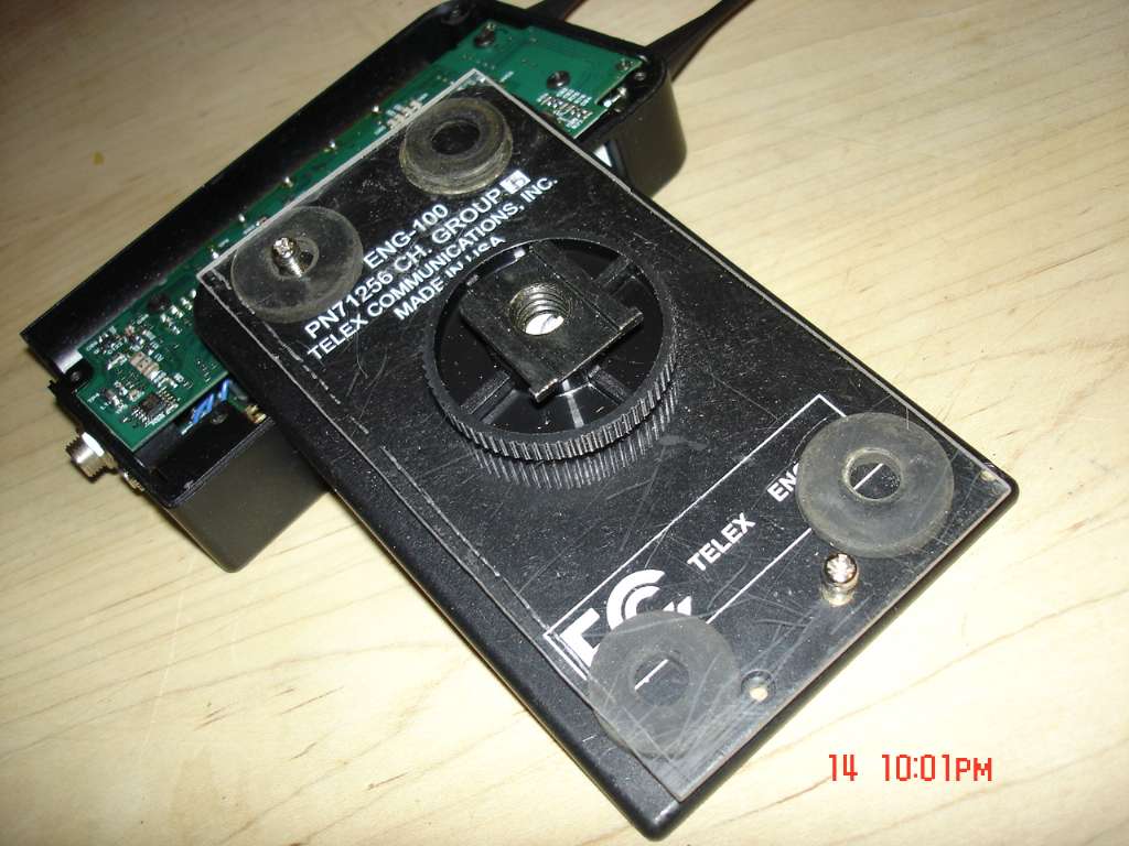

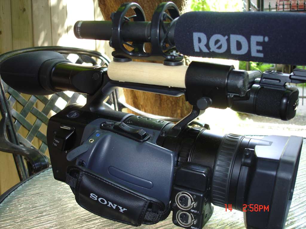

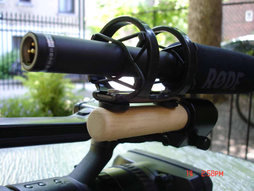

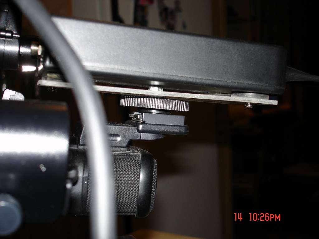

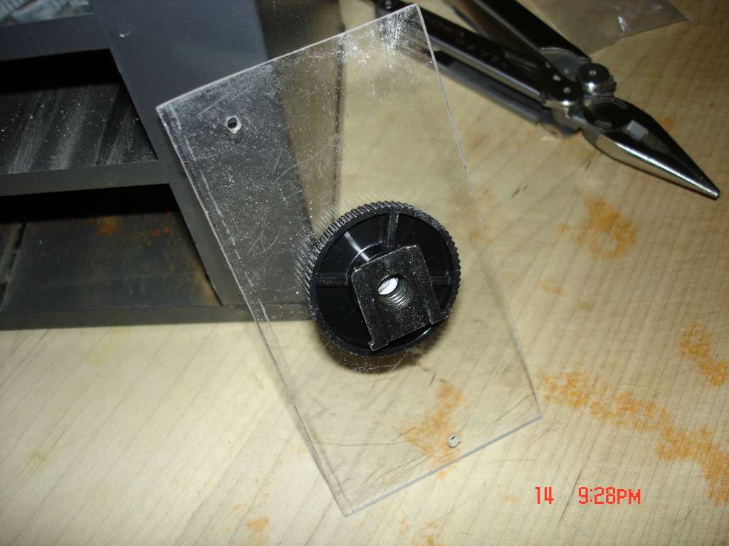

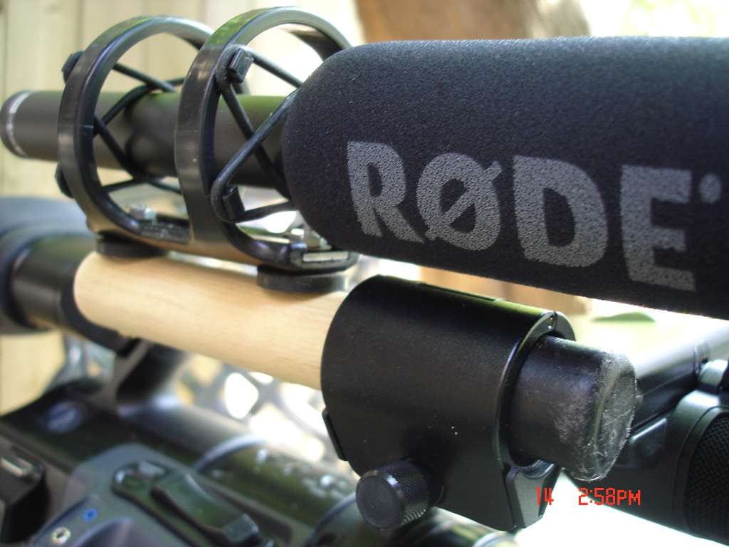

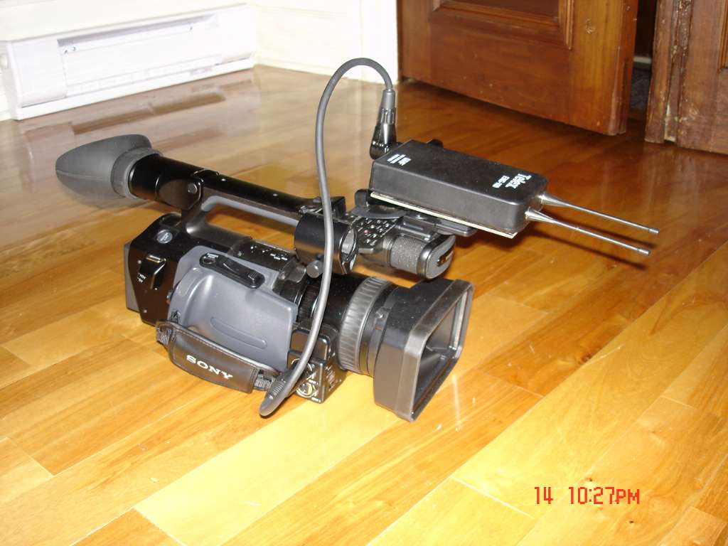

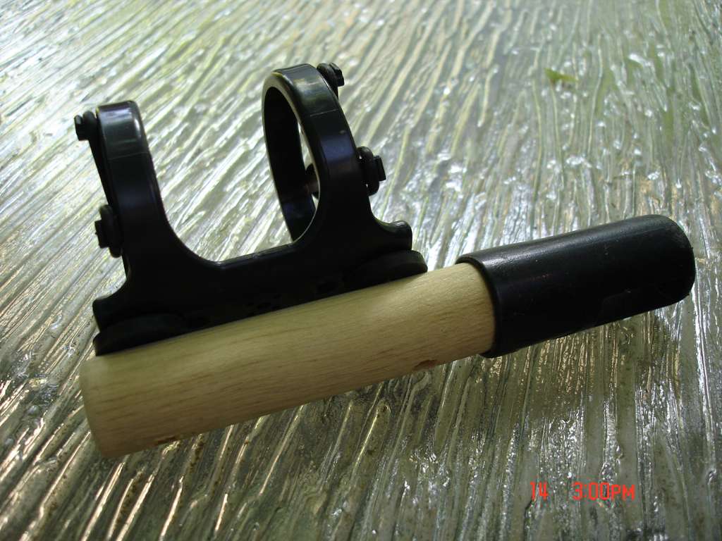

For my Z1, I took apart the shock mount that came with my Rode, screwed it to a bit of broom stick handle that fit exactly in my mic holder, and mounted the shock mount to that. Works like a charm. I painted it blue after I took these pictures The left over shoe attachment came in handy for my wireless transmitter, too, so it all worked out.
I'm guess what I'm trying to say is, don't be afraid to mess around and build something if you can't find a product that will do what you want...
