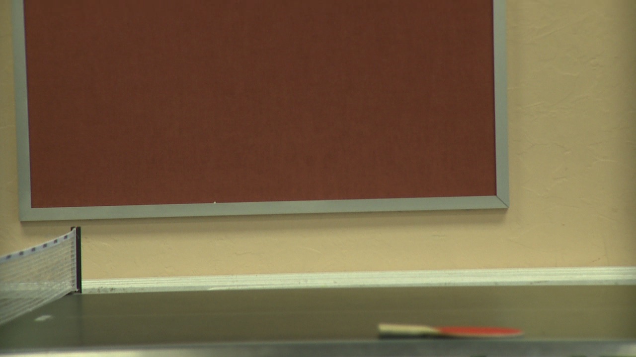

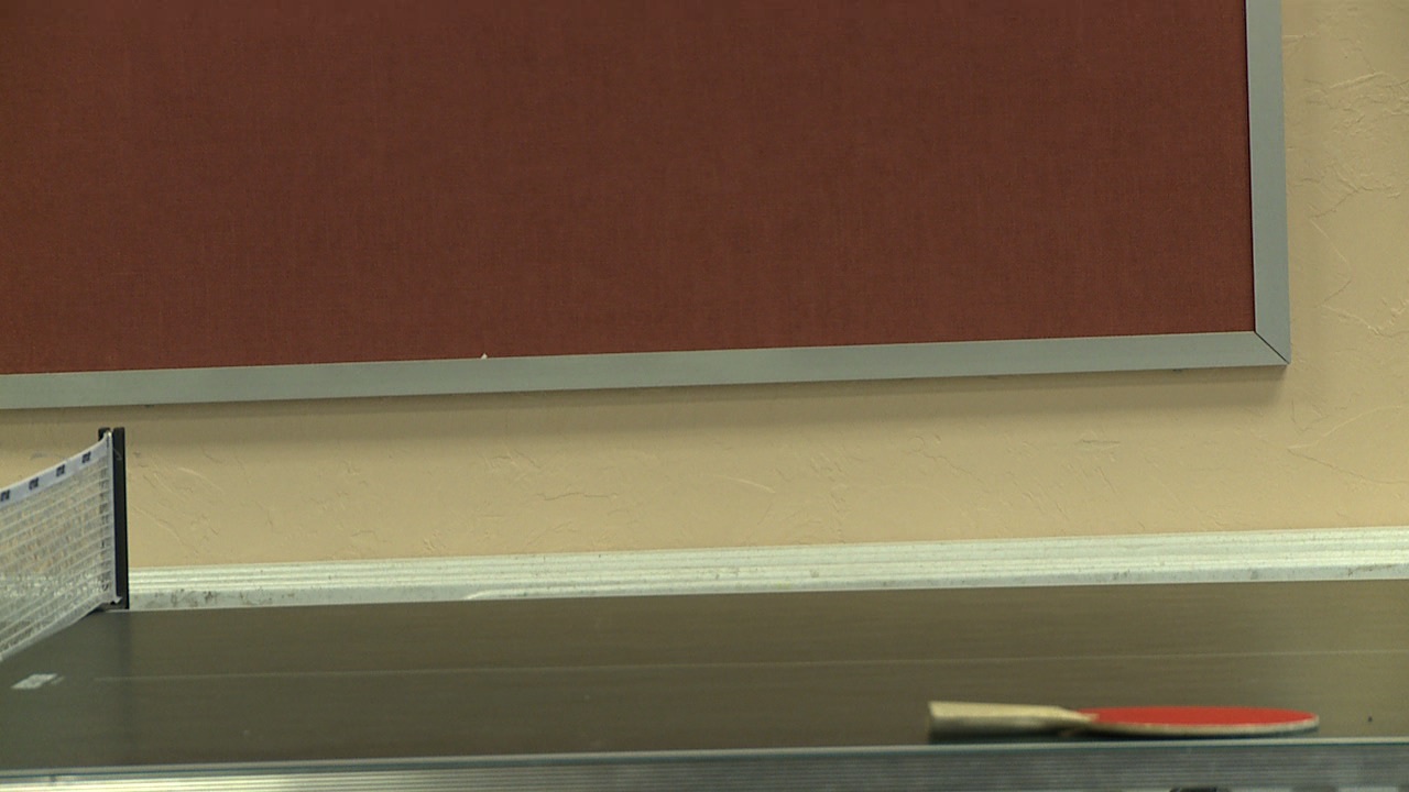

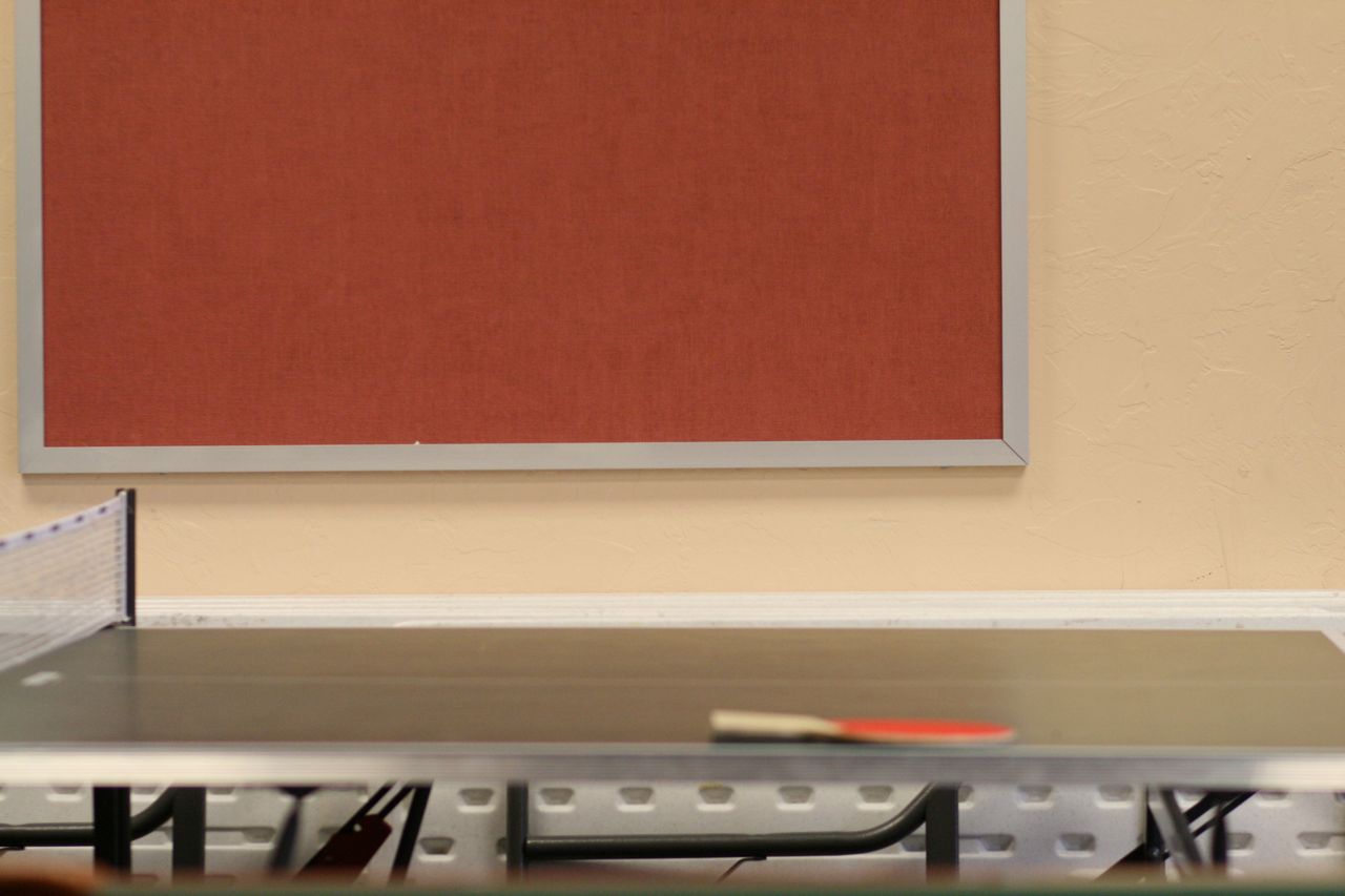

Vince. I have the same issue! I have a letus Extreme and I use an 85mm (see attached original CanonXTiCamera85mm.jpg) Canon EF, and I have a 28mm and a 50mm and a 300mm. I think you are right. I have to zoom in further than I did with a V1U. I even tested it with the Letus35 Flip. I get a fair picture at 80% zoom (see attached Letus35Extreme85mm80zoom.jpg) and a better picture at 90% zoom (see attached Letus35Extreme85mm90zoom.jpg). But that changes my 85mm to a 90mm or even a 100mm. I attached my comparisons.
Let us know what you find out.
Winston

I agree with everything you wrote. The only problem is my Letus does it with any focal length Nikon lens I mount to it at any stop combination. There's a weird thing happening on the right side of the frame that looks like I'm seeing a reflection off the inside of the adapter. It moves into frame as you zoom.
My M2 doesn't do this with any lens, but i hate that's it's upside down.
I'll talk to Letus tomorrow and see what they suggest.
I also talked with Phil and he's having edge to edge sharpness issues, but said that Letus is on it.
Winston, I'll let you know. I hate losing the width on these lenses.
