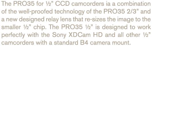

Hi everybody, so I contacted PSTECHNIK. They told me they're working hard on a XDCAM EX version of their adapters. But they don't know when this will be avaible.
Anyway, I was reading the pdf of PSTECHNIK family adapters: I'm quite sure that the PRO35 1/2" version fit any B4 mount camera (like sony XDCAM HD). I attach a jpeg from the brochure...
SO, can anyone confirm me IF the ex3 WITH the included adaptor can accept the PRO35 1/2" version?!?!?!?!
Thank you everybody
Michele

Hi Bob, P+S TECHNICK (mr. Silvio Liberatore) said me they are working hard on adaptor for EX3 (they had a lot of requests...) But he didn't answer me about mounting Pro35 1/2 on EX3 with included B4 adaptor...
Philip Blomm mounted a Canon HD B4 video lens on EX3 (with the included adaptor)... so it's possible... I CAN MOUNT PRO35 ON EX3 WITH ADAPTOR....
What do you think...?!?!?
Michele

P+S TECHNIK told me they are working on EX adapter. PRO35 1/2 is ready for EX3 (with included adaptor). it is expensive. They want to develope a cheaper adapter for EX.
Michele
