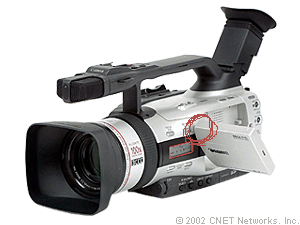

i tried this magnetic method on my sony trv900 - no reaction - am i using a lousy magnet or is there another method inverting the screen on an sony camcorder?
greetz from Aachen, Germany
Maximilian

Some cameras use a physical, nonmagnetic switch based on LCD position. Not all models of Panasonic camcorder seem to use magnets, either.

I would've never tried this on my Optura Xi, but i figured since the GL2 works this way, I'd give it a shot. To my suprise, it works! Makes shooting with the adapter so much easier. Thanks.
And as a plus it is also automatically mirrored, so it's a normal image.

Make sure you try both sides of the magnet. Polarity matters.

I got some small magnits from some magnetix thing I saw at target and I was wondering, how do I go about testing to see if it can be done on my camera? I held the magnet up to different parts of the lcd screen when its past the flipping point, then moved it back to position, I got no results but is that how you do it? Its really hard to do since the magnets aren't that small and obviously dont stick to my camera.

problem with magnets is you always have the screen tilted up!
The problem with magnets is you always have the screen tilted up!
Thus you can't hold the camera above your head and film downwards.
Also taping the magnet in place is tedious.
A better solution is to simply unscrew the 3 silver screws around the lcd screen.
Remove the back portion and then move the magnet sensor from the hinge position and tape it to the back of the plastic housing.
Now you can velcro a magnet to the back of the screen and flip the footage much more easily independent of the LCD's angle or position.

I owned a GL2 for a while and the magnet trick was never a pain as you described. The magnet was powerful enough to just stick on there, and the image remained flipped even if I had the LCD turned any which way. I never taped the magnet in place.

I think you are mistaken. There is no metal on the inside of the plastic housing, thus nothing to stick to.
I have my gl2 in front of me and just tried it.

...nope, I'm pretty confident in my memory. Are you putting the magnet on the LCD between the LCD and the body of the camera?
I used a magnet like this:
http://www.magnetsandhealth.com/cata.../neodymium.jpg
and put it here (see attachment) on the part of the LCD just above the hinge. If it doesn't work for you, Canon has obviously changed their camera design since then.
Maximilian
I have a TRV900 and the magnet trick does NOT work with it. It uses an electrical switch to flip the image, not a mechanical one like many other cameras. Shame, cuz the 900 has one of the best LCD screens out there. I bought an external LCD with line-in. But it's not very practical as the one I got is too big and cumbersome to mount on the camera, so I have it on a second tripod. Basically only good for controlled shoots on sticks. The best solution id to upgrade the camera! CAUTION: I hear some of the newer cameras do NOT work with magnet trick, namely the Canon A1. Viele Gruesse aus den USA!
