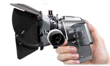

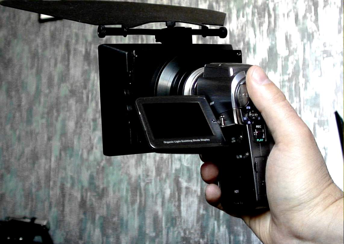

I guess you guys haven't seen the HD1 cine-version I designed and posted quite some time ago?
Dennis Hingsberg is offline   Reply With Quote

Dennis, that's hilarious! Let me know when you're taking orders.

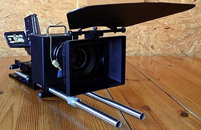

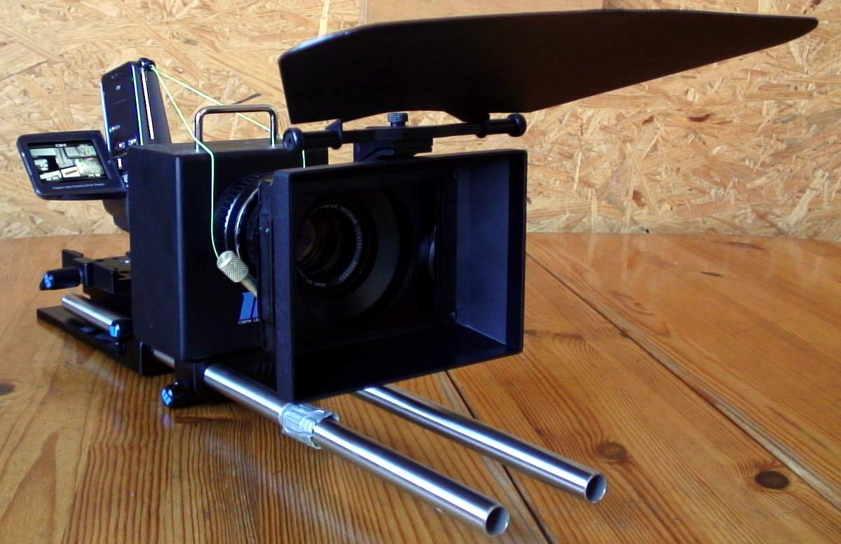

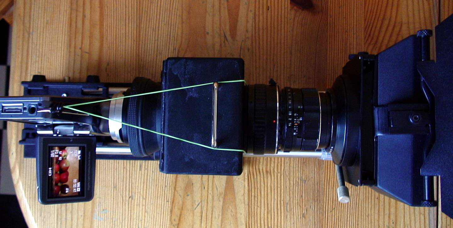

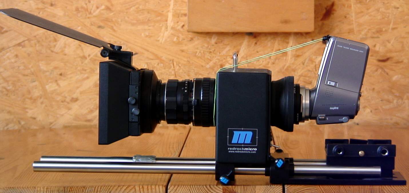

Sanyo HD1+Redrock M2 DOF adapter
the rig :)

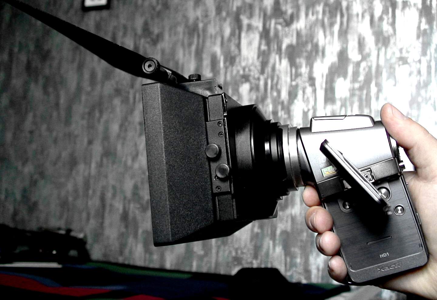

HD1 cine-version
HD1 with matte box :)
What about Sanyo HD1 and 35mm DOF adapters?-cinehd1_01.jpg   What about Sanyo HD1 and 35mm DOF adapters?-cinehd1_02.jpg

Old January 28th, 2007, 11:10 AM   #12
Location: Las Vegas, NV
Posts: 613
Wow!
But I thought it didn't have filter threads though? How are you guys doing that?
"Babs Do or Babs Do not, there is no try." - Zack Birlew
www.BabsDoProductions.com
Zack Birlew is offline   Reply With Quote
Old January 28th, 2007, 11:17 AM   #13
Location: Hungary / Europe
Posts: 128
Originally Posted by Jack Felis
Wow!
http://www.amazon.com/Sanyo-VCP-AL49.../dp/B000FSAS1S

Dennis, that picture still makes me laugh ;)
