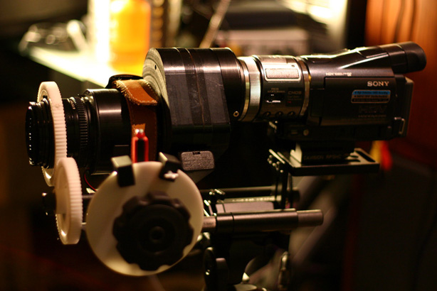

What do letus users use for this (specially the xl series users)?
I have the letus FE , not he Letusxl but I'm sure a follow focus with a whip should be useful. If you can afford it there are some systems with motors available. I'm poor, so I use indifocus with a HC1 .
Here is a picture of my setup.
I hope my 2 cents has been helpful.

that looks good. I'm pretty poor too, so something like this is more likely to get for me. How much does something like that cost (incl rods and everything) and where do you get that kind of stuff?
the follow focos with gears is 389$ plus shipping , you can get a 18" whip for 35 $ extra
They also have some 10 " carbon fiber rods for 99$, 18" for 129
http://www.indifocus.com/
I have the cavision rods, I got them from B&H
cost 159.95$
heres the link:
http://www.bhphotovideo.com/bnh/cont...ughType=search
I would pick up these 2 cavision accessories to maximize stability:
http://www.bhphotovideo.com/bnh/cont...goryNavigation
warning!! the 2 accessories items are often on back order and will take forever to arrive.
If you can, try cavision directly.
the rods themselves take about 2 days to get to you and the indifocus will take about a week. Just remember to remind him once you've made the order, he's a busy guy.

Nice Rig. I was wondering if that Cavision Spacer creates enough space to take out the tape even if you have the rods slided back so that it's under it. I'm wondering because I wanted to get the cavision shoulder mount too so that'd mean longer rods spanning the length of the camera.
I was able to remove the tape. However, it is a tight space. Be careful when loading and removing media.
