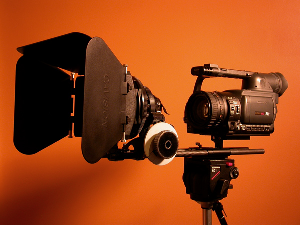

Rods, baseplate, mattebox, and lens support from Cavision. The follow focus is an old Arri single-sided... beefy and doesn't use gear belts. I have 4 Nikon lenses (28mm F2.8, 50mm F1.2, 105mm F2.5, & 135mm F2.8) that I bought from keh.com for about $500. Lens gears from RedRock. The adapter is coming...
Though lighter than expected, I've got my eyes out for a beefier head/tripod.
