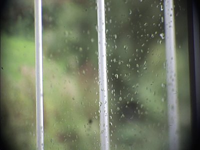

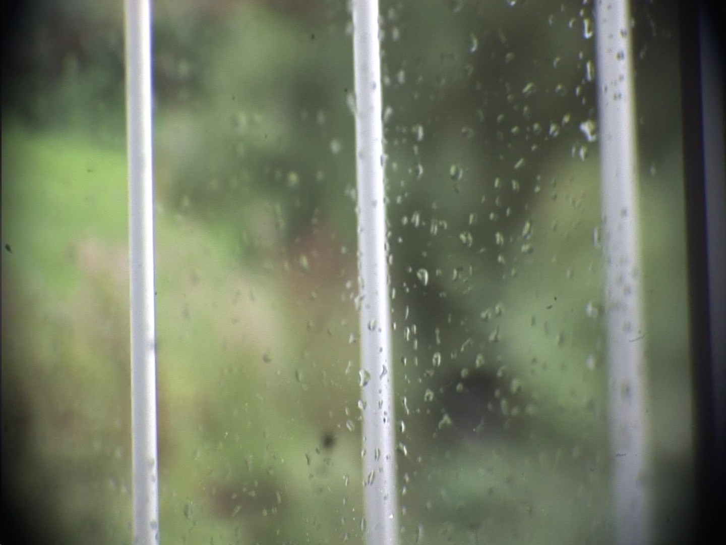

Now, I would love to bombard you with pictures. Problem is, I did not manage to get the image to fill my FX1 sensor. I tried a Letus 58mm acromat (without the rest of the Letus, obviously) and I tried a Raynox DCR 250. The Raynox was almost impossible to handle, but I managed to get 1 handheld shot (I held the lens-screen construction). The attachment shows something like a 3/4 crop of the screen, vignetting comes from the Raynox lens, the unsharpness because, as it was handheld, the optical planes did not align. I the middle of the image, where the raindrops are sharp, you can get an idea of the screen's quality. The image is deinterlaced (as I said, handheld ;-) and rotated 180°, the black spots are dust.
Next I will try to build a simple static adapter with this screen for my FX1. Which brings me to the achromat question: Has anybody got a suitable achromat / close up lens suggestion that is able to enlarge a 36 by 24mm screen to cover the whole FX1 image? Has anybody got an idea how many dioptries / how much magnification I'll need?
Wayne, does your SGPro design require any more lens behind the GG apart from the achromat? If not, how much would you ask for one of your achromats?
Ok, now I hoped to inspire some of you to look more closely into this screen option and we can all do some more testing to verify the claims I made above, which are based on two days of fondling with the screen and doing most evaluation with magnifying glasses and the naked eye. So for now, you may take my conclusions with a pinch of salt.
Canon Ee-s Screen evaluation (and good value static design)-test-ees-screen.jpg

Thanks for sharing the information. I would however like to see moving footage. The grain and dust is much more visible on moving footage than on stills. Also, what lens did you use? F-value?

The problem with moving footage is, that I did not finalise my adapter design yet and have currently no means of mounting screen, lens and camera properly together. Unfortunately, I am off all week (duty travel to the UK) but I will continue to build and share next weekend.
Frank, sorry for my lack of precision. What I meant to say was that the canon screen uses laser cut microlens to diffuse and not a sandblasted surface with random structures. Hence the in-focus areas are not unsharp (blurred by the random screen surface like with a diffusion filter for a camera). That's what I meant to indicate, when I said they are not diffused, which in fact they are (for the reasons you stated above).
I am aware that the test pic I have shown is insufficient to prove anything. I will try to get some footage next weekend, although it may at first be SD (I'll use my raynox converter on my little Pana MX300, that should work to make the screen cover the entire image).

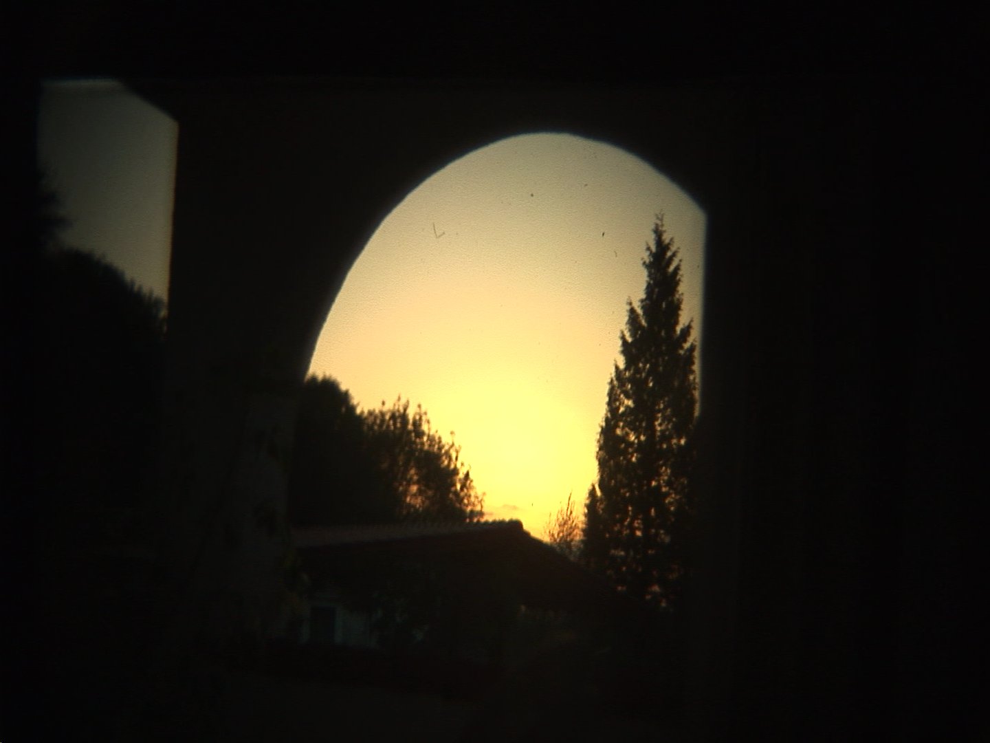

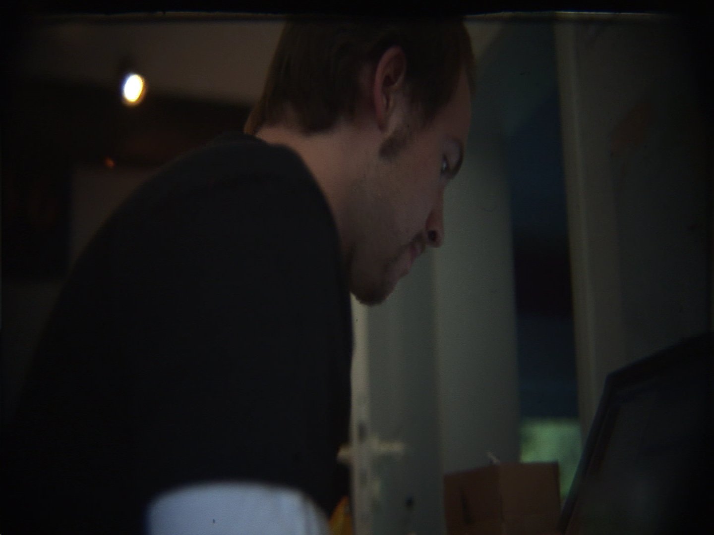

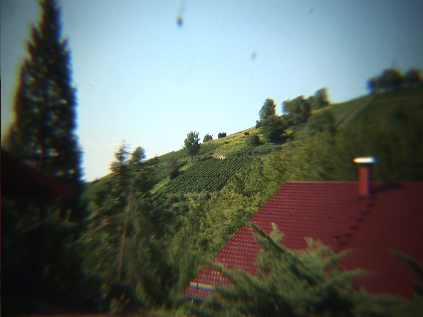

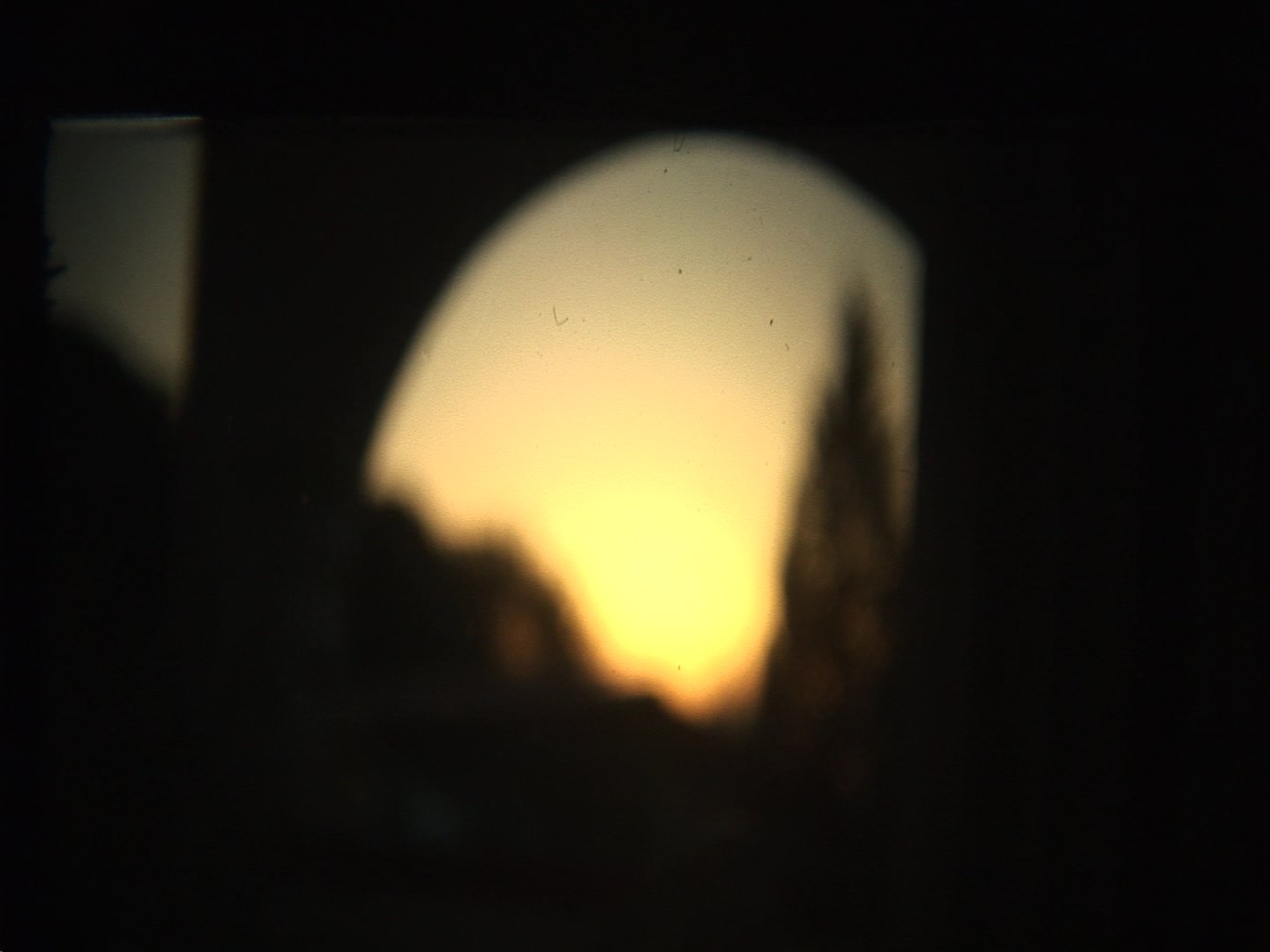

Ok, first an apology for everyone waiting for more info. My laptop PC broke, hence the delay with more material.
Toenis, congratulations on your little oscillator.
So, here we go with more screenshots. With the broken PC I am currently unable to be put a video clip together.
My biggest problem is that I need a better acromat. I tried an aspherical 12 dpt bi convex lens, but it has different focal planes, as illustrated in the first picture attached (hillside view). In the centre, this screenshot also illustrates the maximum sharpness possible with the GG and the FX1, unfortunately the rest of the image is very much distorted by the lens.
As a result, I had to change to using my Letus achromat combined with a 50mm achromat I had laying around (I'll post pictures of my "gaffa tape prototype" later).
The results are almost as sharp in the centre (it was darker that time of the
day, so maybe that's the reason why they are not as sharp as the first shot). However, the vignetting and barrel distortion has decreased significantly as well as the hot spot problem - however, it's not gone :-(
I think the "Garden Bokeh" shot nicely illustrates the bokeh capabilities of the screen.
So now I am back at square one. I could buy an awfully expensive (by DIY standards!) HD achromat, such as the Brevis 35 one, or I can go on to try and error with cheap lens. Any suggestions?
PS: I still think the Canon EES screen produces an excellent picture, well usable for static design. I wish I had a ready made adapter where I could just drop the screen in to show the gorgeous quality. Unfortunately, I am not there yet.
Maybe Toenis (as I understand he has got the screen lying on his desk) can post a screenshot from his adapter with the oscillator turned off.
Kind regards,
Thomas
All shots taken with a 40mm 1.8 lens:
Canon Ee-s Screen evaluation (and good value static design)-canon-ees-screen-hillside-view-sharp-centre.jpg   Canon Ee-s Screen evaluation (and good value static design)-canon-ees-screen-garden-bokeh.jpg
Canon Ee-s Screen evaluation (and good value static design)-canon-ees-screen-working-pc-dark.jpg   Canon Ee-s Screen evaluation (and good value static design)-canon-ees-screen-sunset-focus.jpg
Canon Ee-s Screen evaluation (and good value static design)-canon-ees-screen-sunset-out-focus.jpg

thomas, FX1 should be able to focus that screen without vignetting/hotspotting without acromat and so on as HVX200 could almost do that.
Try different camera to screen distances and so on. EE screens have focal distance of ca 50mm I quess and camera should not be placed only 10mm away from focusing screen as that can produce some serious hotspotting.

Toenis, the focus of the fresnel on the screen is a very good point indeed! I'll try moving further away and focussing directly on the GG.
Martin, I dont have the optosigma, so I cannot compare. However, I find the screen itself (in a static setting) better than my letus screen if used static (I know it is not supposed to).
What I am intending to build is a static design to avoid moving grain issues. I may fail, but lets wait for Toenis' shots, which will be taken in a real professional environment.
Please disregard the dust for now. I'll buy a new, untouched screen once the constructing is done.
