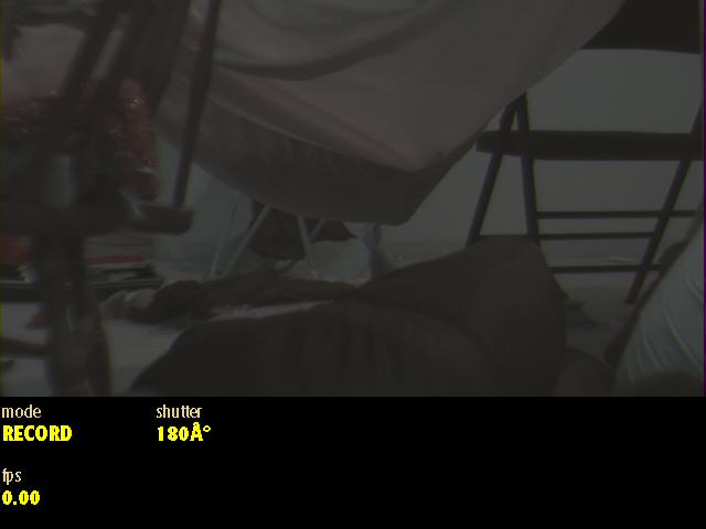

Screen shot
It's not much to see, but here is a screen shot from ObscuraCap in capture mode. It's not perfect yet -- note the "0.0 fps" display. The upper portion of the screen is a 640x360 16:9 "eyepiece" preview. There is also a 4:3 mode. It's a full-screen interface: no menus (etc.) during shooting.
