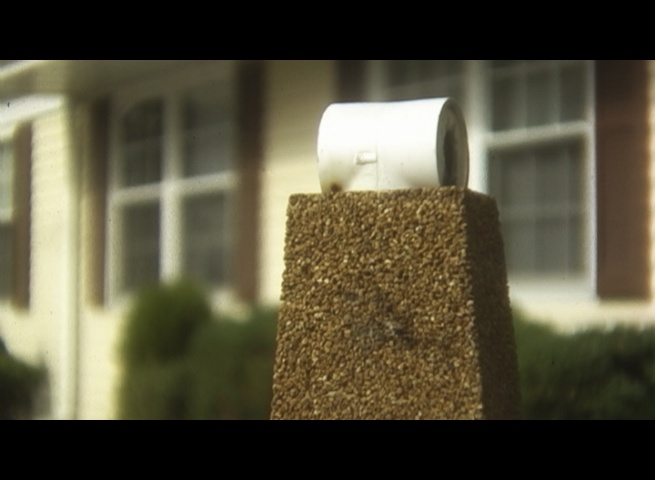

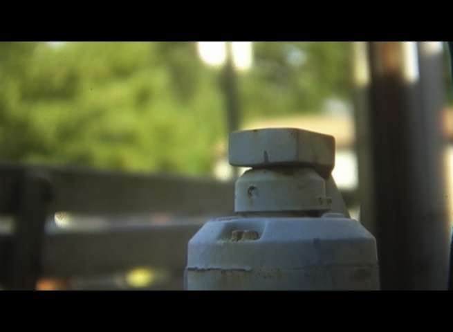

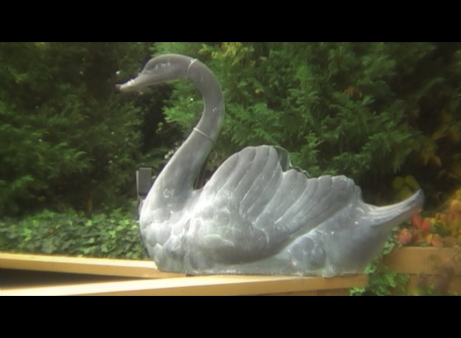

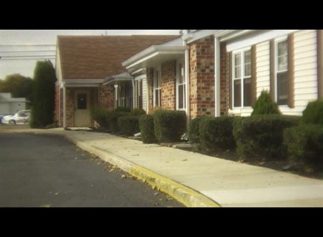

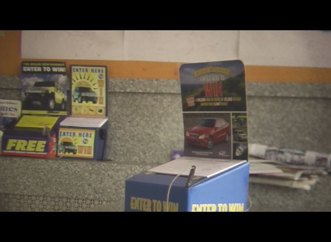

Toenis Liivamaegi
Here are a few still shows taking from footage using:
the panasonic pv-gs300
a adapter made using the Canon EE-A focusing screen, a 10x asian macro, and the Canon EOS extension tubes
I took plastic from a cd case to make the holder. With a better holder, like you vibrating one and a better macros, I think this would be a decent adapter.
I'm posting the still to show another POV, as far as using the canon EE-a Focusing screen.
I do have one question. do you accept paypal?

Paul, I assume that your design was static and matte side of the EE-A screen was facing your camcorder lens? BTW I have sent you an e-mail too.
Why are you using 10x macro on Panasonic GS300? As far as I know it should focus on 35mm frame without any resulting in much better image quality and edge sharpness. We have tested it with GS150 and GS500 without macro and it worked well, no chromatic abberations or edge softness. Even HVX200 almost made it without macros, but almost.

Hi Paul,
The 5 images above, what adapter setup did you use, static or vibrating?
Not bad images, the odd speck on the screen but all in all not bad.

Hey Tony,
the design was static. I'm working on a vibrating model . the problem is the gg holder. If I had a good gg holder that dampens the sound and localizes the vibration I would have no spots. Hence, my interest in this forum
please share any info on the matter.
