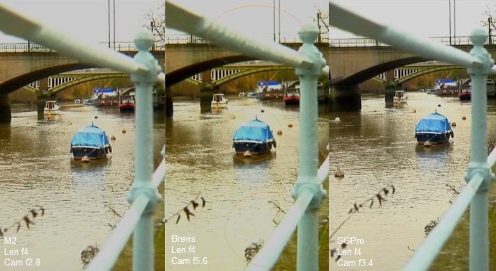

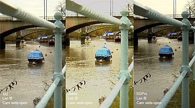

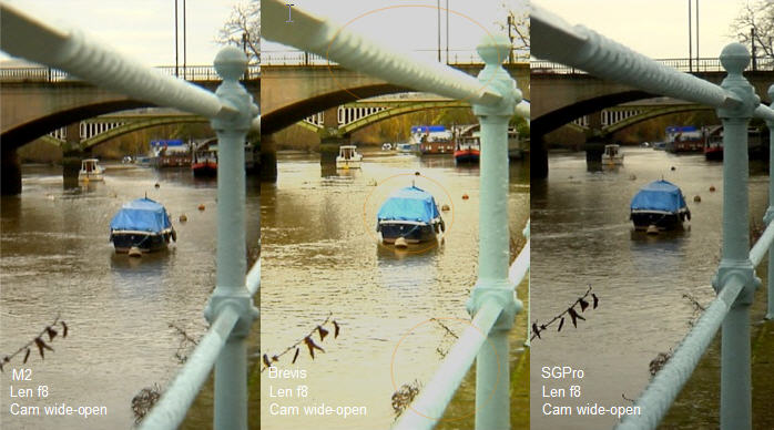

Thank you very much Dennis, now I understand why Brevis is shorten then other adapters because of the use of bigger achromat.
But I have a question about the handling of exposure & midtone with Brevis, I remembered I have asked you before and your suggestion is to use more ND to prevent over-explosure.
Phil, please can I know how much ND you have applied to Brevis when doing the test ?
I am happy to step-down aperture and add more ND filters but my concern is whether the image will still look as nature as SGPro ? Please see my attachment for what I am concerning...
Sorry to Phil, as I alter your image without your permission first ;p. As you can see, even Brevis have aperture closed down 1 & half stop but the image still over-exposure...
Phil, if you are going to make the test with CF3 soon, please can you try to make the image without significant over-exposure, I just wonder how much ND & aperture-closing will Brevis need and how would the image look like ?
many thanks again.

Ing, the overexposure is NOTHING to do with the Brevis...it's to do with a tired and cold camera operator.
No ND was used in any of the tests. Yes if using the Brevis in a bright day outside with the standard diffuser ND on the 35mm lens is recommended.
Ing I will try not to overexpose in the future!!!!! What it does show is I am able to overexpose the Brevis at F8 when the other adaptors I couldn't even get the correct exposure!!
Philip Bloom

Thank you Phil for your confirmation, so overexposure is nothing to do with Brevis... I saw many sample footages from Brevis users (including Dennis own sample), most of them have a lot of "over-exposure" here and there, Dennis told me that makes more filmic look while I really don't like that look and feel (as real film has more lattitude even in over-exposure image).
That is why I keep wondering can Brevis make a good outdoor image without over-exposure ?
Since you confirm it is nothing to do with Brevis, please can you tell me based on your experience, what f-stop and ND would be required for the same image you took in the test which would prevent over-exposure ? will it make even darken then SGPro in a very un-nature look and feel. Yes, another thing I find out about many Brevis footages are, either a lot of over-exposure or simply too dark, another filmic ? Like a recent footage from Brevis user: Christopher Barry at www.siliconcine.net, he got the similar problem in handling exposure in his latest outdoor test (test 3, Brevis with Nikon 85mm F2.0), either too bright or the front-object is too dark to see...
I am really worrying that the range of mid-tone from Brevis is far too less comparing to SGPro & M2.
Or trying to keep good image without over-exposure is just as difficult as trying to keep minimun light lost in M2 & SGPro ?
Or it is the trend of filmic from everyone ?
mm.. next time please call me out too, I will make sure you will get very comfortable in making test, such as bring extra jacket and some hot drinks.. or some asian-curry :p.. And I can carry heavy stuff for you, that might help a bit :D.
Using the same lens f-stop you would use a ND4 (also known as .6) to stop down by exactly 2 stops and get the approximate same exposure level.
It would make it darker for the SGPro or M2 so you would not use the ND filter in that case.
Hope that helps.
